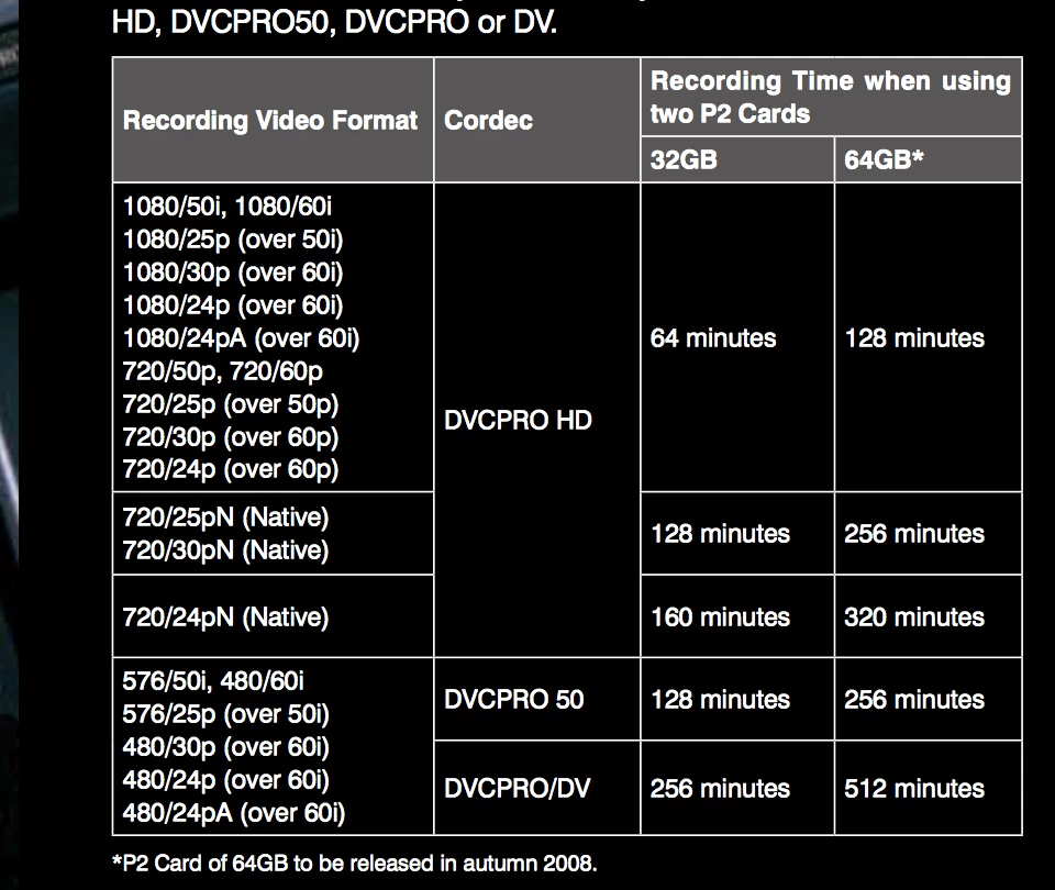

I understand your reaction as it does seem a bit weird to wrap the progressive frame in interlaced footage, but I'm quite sure that's how the HPX works. I've been doing quite a bit of reading on DVXuser.
January 15, 2017
From Panasonic, the recording options on the camera:
If you are recording in the 1080/25p (over 50i) setting, you should be able to drop the footage on a 25p timeline with no visual consequences as for each frame of the interlaced footage, the two interlaced fields that make up the recorded frame will have been derived from the same progressive frame from the sensor.
