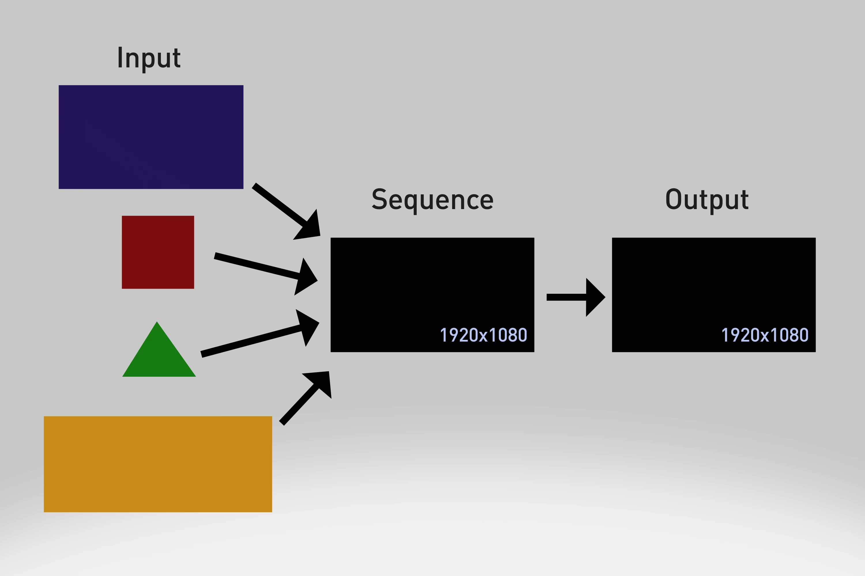

Working with mixed formats happens all the time, but you can only have one framerate and resolution for your video so you do need to pick one. Whatever your primary source media is, whatever your spec sheet requires, or whatever your intended video spec is, that's what you'd choose. In the example picture below, if my intention was to create a 1920x1080 video at 29.97fps, then that's what I'd set up as my sequence and that would also be my output (export settings). No matter what video I put into the sequence that's going to have to conform to those specs.

When you have mixed aspect ratios you really have three options:
  • Stretch the clip to fit (which you would almost never do)
  • Crop the clip so that it fits the full frame
  • Leave black bars (letterbox or pillarbox) on the video so that you can see the whole thing without cropping
    • You can do things to fill the frame, like making the video blurry and upscaled in the background or use the negative space for text, etc.
Like I said, you can make presets or copy and paste motion properties to clips, but when working with extreme aspect ratio differences there is almost always going to be manual work involved in composing shots the way you want them. You can look at Adobe's relatively new Auto Reframe feature, but that's more for going from one already finished sequence in on aspect ratio into a new sequence with a different aspect ratio. I don't think it would be much help in adding media into a new sequence. But in general if you're cropping 60% of the frame from a shot, someone has to decide what stays and what goes. That's going to be you. And if it's not you, it would have to be AI-based, making the decision for you.
