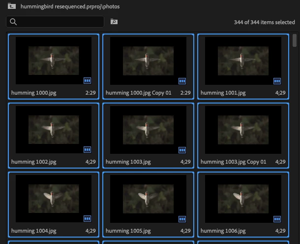

I'm doing a project for which I first generate an image sequence from a clip. Then I would go into the sequence of images and do some rearrangement of them. Surprisingly, I have not been able to do this seemingly simple task so far. Here's what I have tried.
In the Project Bin where all of my images are, I clicked the 'list view', sorted them by name. this gave me the exact order of the images that I needed.
Then, I clicked the Icon view. Set the sorting to 'list view sort'. This retained the order of the images as before. I then tried moving an image to another spot but it turned out that reordering in this setting wasn't allowed.
So while I was still in the Icon view, I clicked 'User order', hoping that would be able move that image around. However, the icons were now sorted in a completely random order, instead of the order as I established with the prior steps!

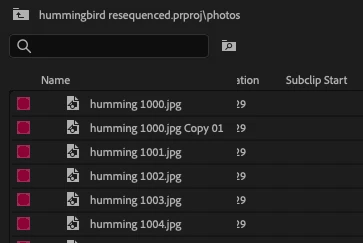

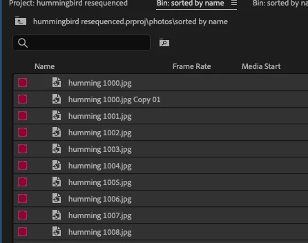

I had a bin named 'photos' where I stored all the images. I clicked on the 'tape name' to sort them based on the file name. It did exactly what I wanted and sorted the files by name, e.g. humming 1000.jpg, humming 1000.jpg copy 01, humming 1001.jpg. etc.
Then I created a new bin named "sorted by name".
Then I selected the sorted images and copy-n-pasted them into the new bin (dragging them had the same result.) Here's how the new bin looked in List view (which is what I desired):

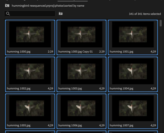

Then I switched to Icon View. Notice that the new bin condinued to display the images in the desired order in "list view sort".

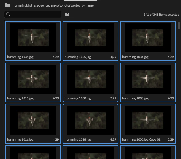

However, when I switched to "user order", the images showed in an entirely different (random) order.
Unfortunately, this screwed me up because it has no order for my purpose at all.

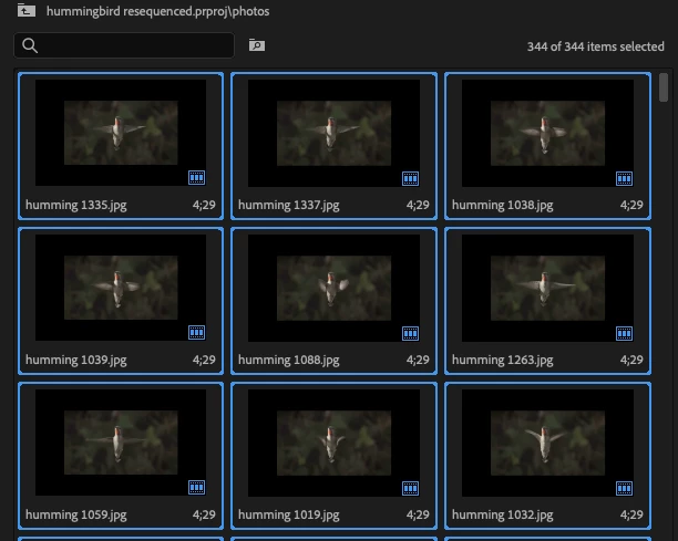

As you can see, in the second row, I have a file named humming 1003.jpg Copy 01, which is a file that I want to move to the first row. But I can't do that in the current "List View Sort". So I switched to "User Order". But then it immediately display all the files in a different order as below:
As you can see, the order is completely random (and I can't possibly work with that order.) I can't even find the file humming 1003.jpg Copy 01 in the first few rows! Let alone moving it to the right position. Therefore, I couldn't even reach the stage where I could apply the function "Automate to sequence".
