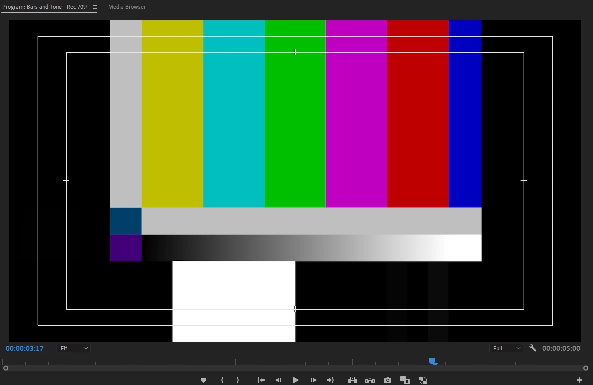

I'm recovering old DV SD footage (720x576 25 fps) and have taken that footage and processed in Topaz Video Ai to De-Interlace and Upscale to FHD Frame 1920 x 1080
Also applied De-noise and HQ improvement which make the footage very watchable.
In some clips with the old DV cameras 'in camera stabilisation' was not even thought about and as a result, some footage on long zoom is a bit wobbly
I've applied Warp Stabilizer and this does a good job on Stabilise/ Crop / Auto Scale apart from the fact you can see the edges of the 4:3 video frame moving about slightly (in the black areas of rest of 16:9 frame) after Warp Stabilizer has been applied
My sequence is 1920 x 1080 25 fps.
Its late and I can't get my head around how to get the 4:3 frame rock solid
Would a mask help out?. Can anyone help out here with an easy solution as I'm sure this is a common issue.
Thanks

You can also try using the crop effect underneath the other effect(s) in the Effects Control Panel (and place black video in a track below if necessary).

Drop an adjustment layer with the crop effect in a 4:3 setting over the footage. Save as preset.
Probably need to scale the footage a bit up.
By @JonesVid
The easiest now is to go to Graphics and Titles > New Layer > Rectangle and create two rectangles that you place right and left. Change the color from the default grey to black in the Effect Controls. This layer can be re-used when needed.
