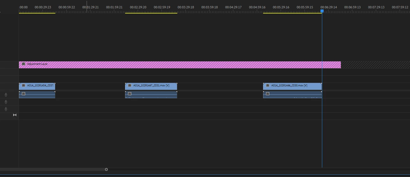

Here is the most basic use case. I created a new blank timeline added three clips and locked an adjustment layer above. "Ripple Delete" works but "Close Gap" does not.
Ann Bens
January 14, 2020
As Rik already stated.
The are not really gaps as there is this AL superimposed. Does not matter if its locked or not.
