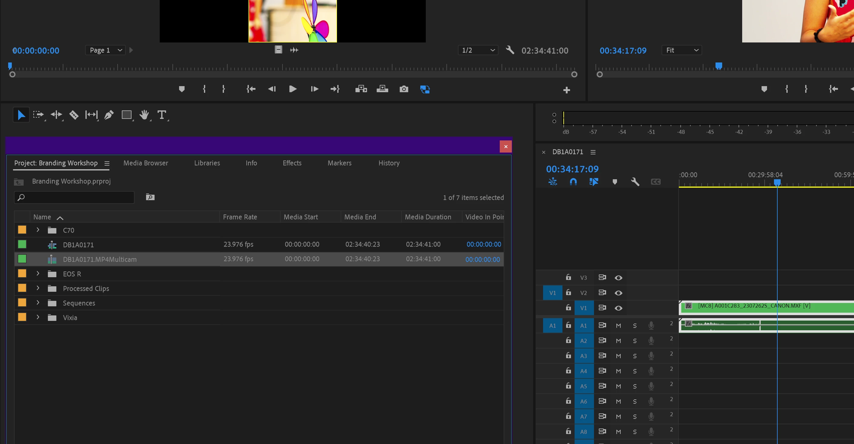

    In your project window, right click on the "Multicam" thing that was created after you built your multicam sequence. Click "Open in Timeline". This basically brings up the nested sequence that was created. Then you can go to whichever clip and make the adjustments. Those are then reflected in your mutlicam sequence.

    Running into this same issue. If you go to the multicam sequence and click on the panel you want to zoom in on.. go to Effects.. Scale.. set to 150 or whatever. It scales ALL the clips in the multicam. There has to be a way to do this.

    double click on your multicam sequence, this will open the source sequences,
    right click on the sequence you are referring to and set to frame size or adjust
    its scale from the effect controls panel. This will update its size in the multicam sequence

    I have tried double clicking from the timeline and the source multicam seq. Nothing opens that allows me to adjust the size so far.
    April 28, 2018
    You'll have to adjust the original clip in the Source Sequence.  Right click on it from the bin and select Open in Sequence (or Timeline, I forget).
