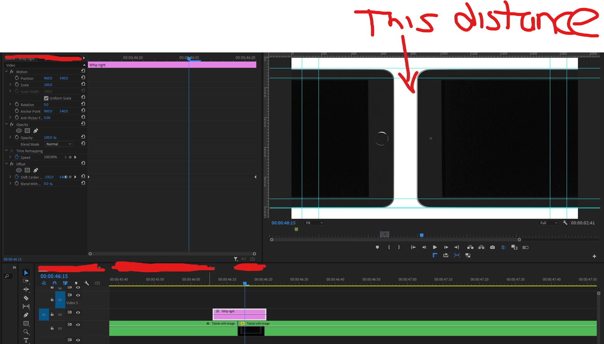

I am able to whip pan using the offset feature but can you change the distance between the 2 videos
  • September 15, 2022
  • 231 views
If someone figures this out for me, all i can say is wow! this has been a long time where i have searched for ways in achieving the look I'm after, which im only ever able to pull off via AfterEffects
Basically, as you can see from my timeline I have an adjustment layer with an offset to create a whip-to-right transition.
I have moved the play head a bit into time so you can see the effect of the offset and distance between the 2 tablets, basically, i want to have this distance larger apart and not so close as its whipping... (im guessing this is not possible)
I can easily do this in after-effects with nulls etc, but feel it's overkill to use AE especially when I have a few scenes I need to animate this way.
Any help from you guys is greatly appreciated.
Cheers...
P.S the closest i am getting is having to manually create position keyframes while overlapping the 2 clips but its not turning out the good

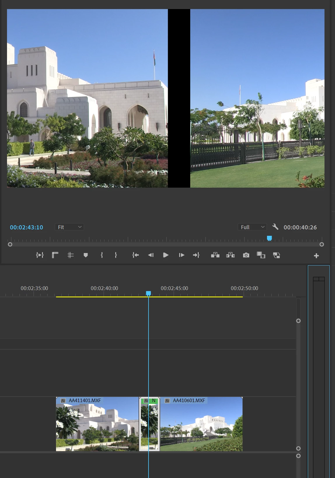

This might help
https://www.youtube.com/watch?v=ZsnWsMpUo2Q&t=134s
The animation is setup in the nest. The length of the nest determines the speed of the animation.
Instead of joining the clips leave a gap.
