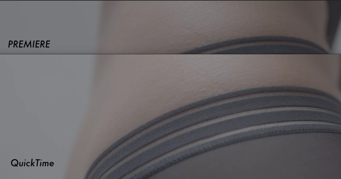

Here's work flow issue:
If I export a video in log (with color management turned off, and no QuickTime compensation LUT, also attaching an image here of this occuring), when I open the video in QuickTime the color is altered, and does not match what I see in Premiere. Let's say I then send it to a colorist, he/she grades it, sends it back,  I drop it back in Premiere to add graphics back or supers or something, when I export that again my guess is the color is going to get altered again, and won't match the work the colorist now did.
So what is the right way to work this? Is it to always use the QuickTime compensation LUT that's floating around on the internet?

Yes, as you are not working with a monitor that's set to D65, 100 nits, Rec.709 and gamma 2.4, you won't get precisely what you hope for. They all matter, all of those settings.

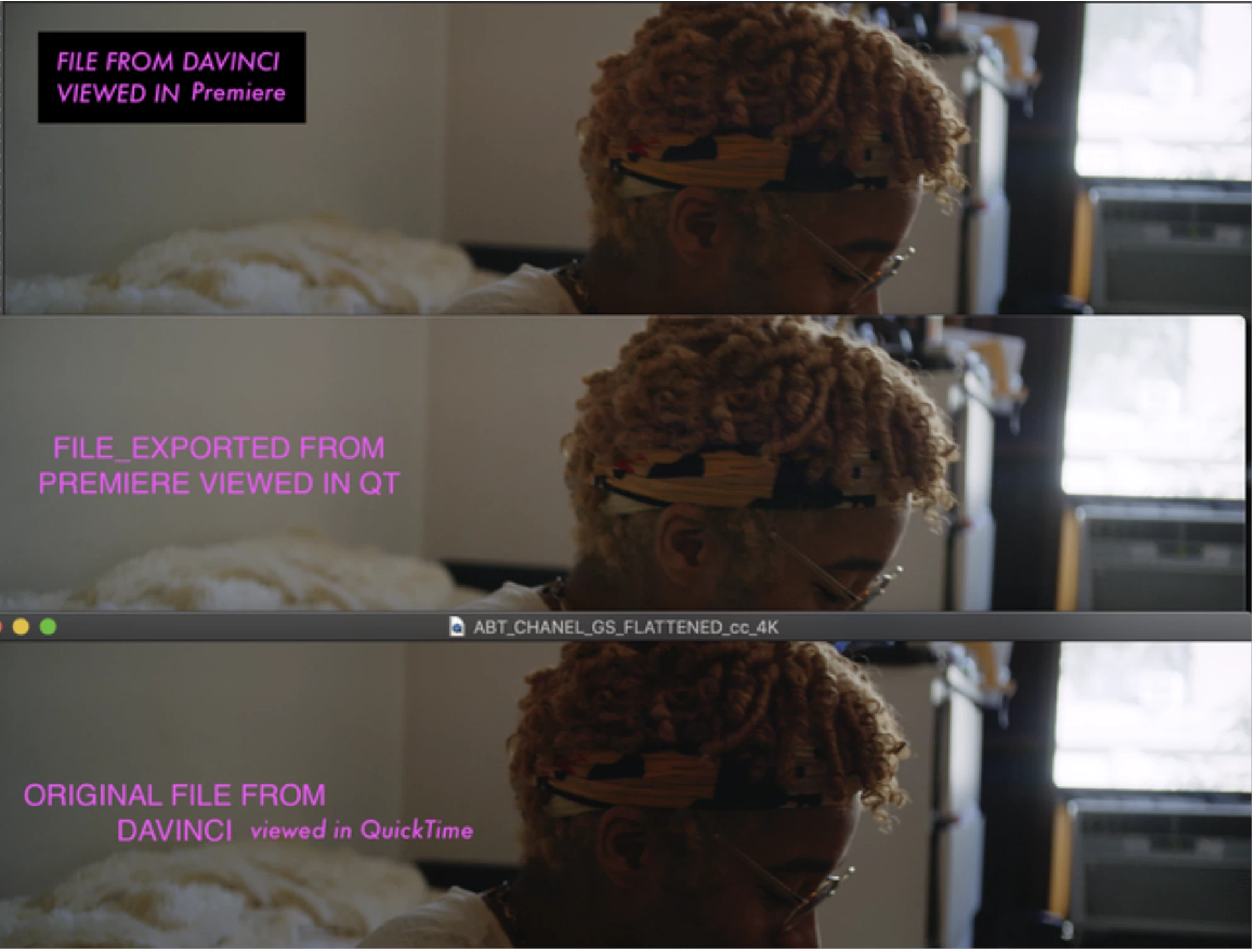

Second ... what is the format/codec you're getting back from the colorist out of Resolve? And how did they export the file, as straight Rec.709, or as Rec.709A? If they're giving you the Rec.709A export option out of Resolve, I think that would do at least something similar to this. I would not have them use the Rec709A tag on export especially if I was going to do more work in Resolve.
On my system, anything I export out of Resolve comes 'into' view in Premiere virtually identical.

You need to get a lot more edumacated about color management if you're working with a real pro colorist who is using a fully calibrated and profiled pro reference monitor system.
Premiere is hard-coded to be used on a system like a colorist would use ... full-on broadcast standards scrupulously tested on the gear. Color space of sRGB, white point D65, Rec.709 profile using both the camera and the display transform function, gamma 2.4, white point brightness of 100 nits in a semi-darkened room.
A colorist typically has more expensive calibration kit/software than most editors have systems. And their Grade 1 Reference monitor (not at all a computer monitor) is fed a signal from a break-out box to get a clean signal without interference from the OS of the computer or the graphics card. Most often BlackMagic or AJA gear for that.
On such a system, Premiere is near flawless in color management issues.
Outside such a system, things get dicey but not because of Premiere. It's because nearly everything on a normal computer system is intentionally screwing with the pixels to either "enhance the viewing experience", "enhance the gaming experience" ... or even worse, both.
To begin on the Macs ... the "newer" Macs with Retina screens use a version of Apple's ColorSync utility that intentionally applies only the camera transform function of the Rec.709 video standard but not the also required display transform function. So when they then apply what they call "Rec.709 gamma" ( though technically there isn't such a thing) it's essentially roughly equivalent sort of to a gamma around 1.95 or 1.96, depending on who's reading the curve.
This, when applied to standard Rec.709 media, lifts the black point and shadow values and seems visually to lessen saturation there. You don't realize this on media you didn't create, because ... you've only seen that media on your system. And probably assume what you see is what was intended. (It wasn't.)
Adobe came up with the preference option for "Display Color Management" which tells Premiere to look for the monitor's ICC profile, and remap the image on Premiere's internal monitor panels to come as close to a proper Rec.709 image as possible simply using the ICC profile of the monitor. It does a decent job. Within Premiere.
But it cannot change the way ColorSync works, so outside of Premiere on that Mac, the tonal values of black through mids are lifted significantly and saturation seems lessened when viewed through most applications and browsers.
The export LUT they offered "fixes" this by over-darkening the mid to black values, so that when viewed on a Mac outside of Premiere, it looks like it did in Premiere.
There's a rather major problem here: when that file is then played on any system with a proper Rec.709 view, the blacks will be crushed and the shadows over-dark. Just like they warned it would in the initial offer of that LUT for Mac users.

Thank you for putting all of that together! It's exactly why I'm confused.
I'm embedding an image below as another example. The bottom image is the file straight from the colorist viewed in QuickTime, the middle image is what happens when I take that file from the colorist drop it in Premiere, re-export it, and view it in Quicktime, and then the top one is when I view that file from the colorist in Premiere (sorry they're out of logical order). Why do you think there is a gamma bump in the QuickTime coming out of Premiere?
Here's another question: I have a client who asked me to extract MXF files from a DCP, and turn them into a single consolidted h264 file. When I export the file, the color of the MXFs in Premiere and the h264 in QuickTime is vastly different. The client wants to see them matched, so I use the Compensation LUT, and it works. If I load the matched file into a VOD platform, and someone winds up watching that matched file on their TV, will the color look terrible?

<a href="https://ibb.co/GcRtFsb"><img src="https://i.ibb.co/m64XSvM/COLOR-TEST.png" alt="COLOR-TEST" border="0"></a>
