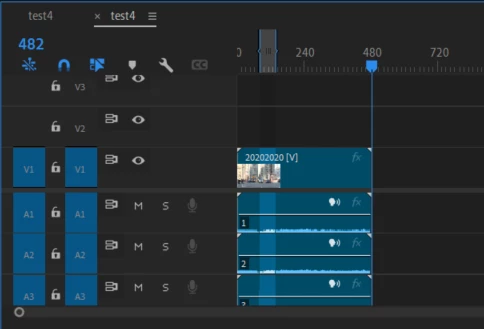

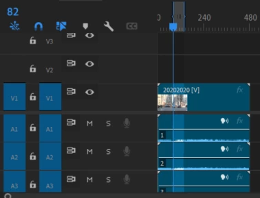

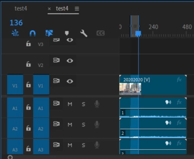

In, out frame information, I checked the API, but something seems different, so I need to check if this API information is correct. The attached picture is the activated 29.97 drop sequence.
The timeline time view was set to frames.
The picture is the value moved by using the go to in context menu.
in point
out point
I checked this and called it from the API.

in frame: 82
out frame: 137

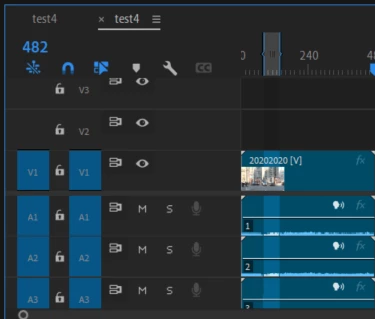

Just in case, I tried the logic of processing it with getFormatted.. As expected, it seems to have a 1 frame difference.
When checking with the end value, it was confirmed to be the same.
var durationTime = new Time();
durationTime.ticks = activeSeq.end;
var timeAsText = durationTime.getFormatted(currentSeqSettings.videoFrameRate, app.project.activeSequence.videoDisplayFormat);
timeasText : 482

How can I get the exact value? Or should out always subtract 1 frame?
Correct answer Bruce Bullis
You have the exact value (computed in ticks); PPro's UI is displaying the time value, at the proximal frame boundary.
