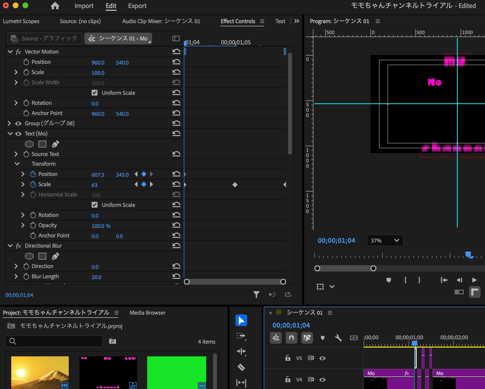

I tried to create an effect where the letter “Mo” vibrates after moving using scale and blur.
I wanted to create an effect where the letter “Mo” vibrates after moving using scale and blur, but the effect is affecting other letters outside of it.
I want to apply the effect only to the first “Mo.” How can I do that?
 The video demonstrates the effect in action. In the screenshot image, you can confirm that blur and scale are being used.
Any advice would be greatly appreciated.

duplicate your text clip, use masking from Opacity.
mask out Mo from one of the clips, mask out the other letters from the other.
apply your position and blur vibrate keyframes to the Mo clip.
Let me know if you are stuck to create a fast video tutorial.

Try rendering the timeline or
make the vibrating text a separate graphic
and use ease in/out on the keyframes.
