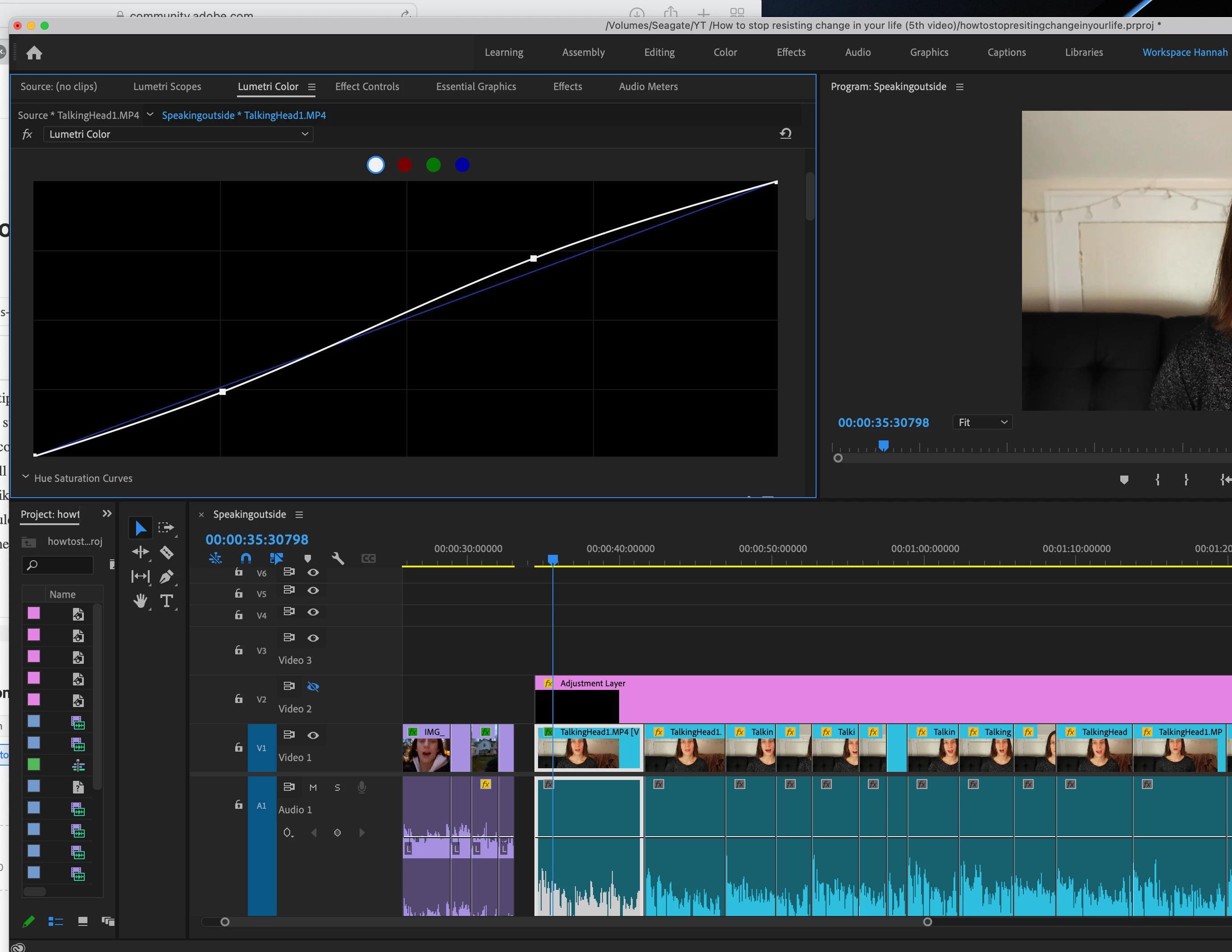

I want to apply lumetri color "curves" settings to multiple clips- Color Correction to multiple clip
  • November 11, 2021
  • 3114 views
I want to apply lumetri color "curves" settings to multiple clips. I am familar with using command c and then command v for applying changes made in FX control such as scale and then applying it to mulitple clips but I have not figured out how to apply the same lumetri color curve adjustments to multiple clips. The idea was that I would make some minute changes globally to all the individual clips and then have an adjustment layer over that that would further unify the clips.  I would like to color correct and then maybe use the adjustment layer as a color grade just as a clarification. What would you recommend? I just don't want to have one clip brighter or darker than the next one like i had in another video before this one. Thank you!
Correct answer R Neil Haugen
You can do this in a number of ways.
First, I'll typically find by viewing large thumbs in a bin, that many clips from one camera are nearly identical. I'll correct one on a sequence of only that clip, copy then 'cut' the Lumetri instance from the Effects Control Panel of that sequence, select all those clips in the bin and past ... Ctrl/Cmd-V the Lumetri effect onto all of them at once.
This method puts that Lumetri effect on the Source settings for all those clips, and will be applied anywhere in the project any bit of any of those clips is used.
You can copy a clip in a sequence then select other clips and select "paste attributes" which brings up a dialog box allowing you to select which attributes (effects) to paste to that group of clips.
