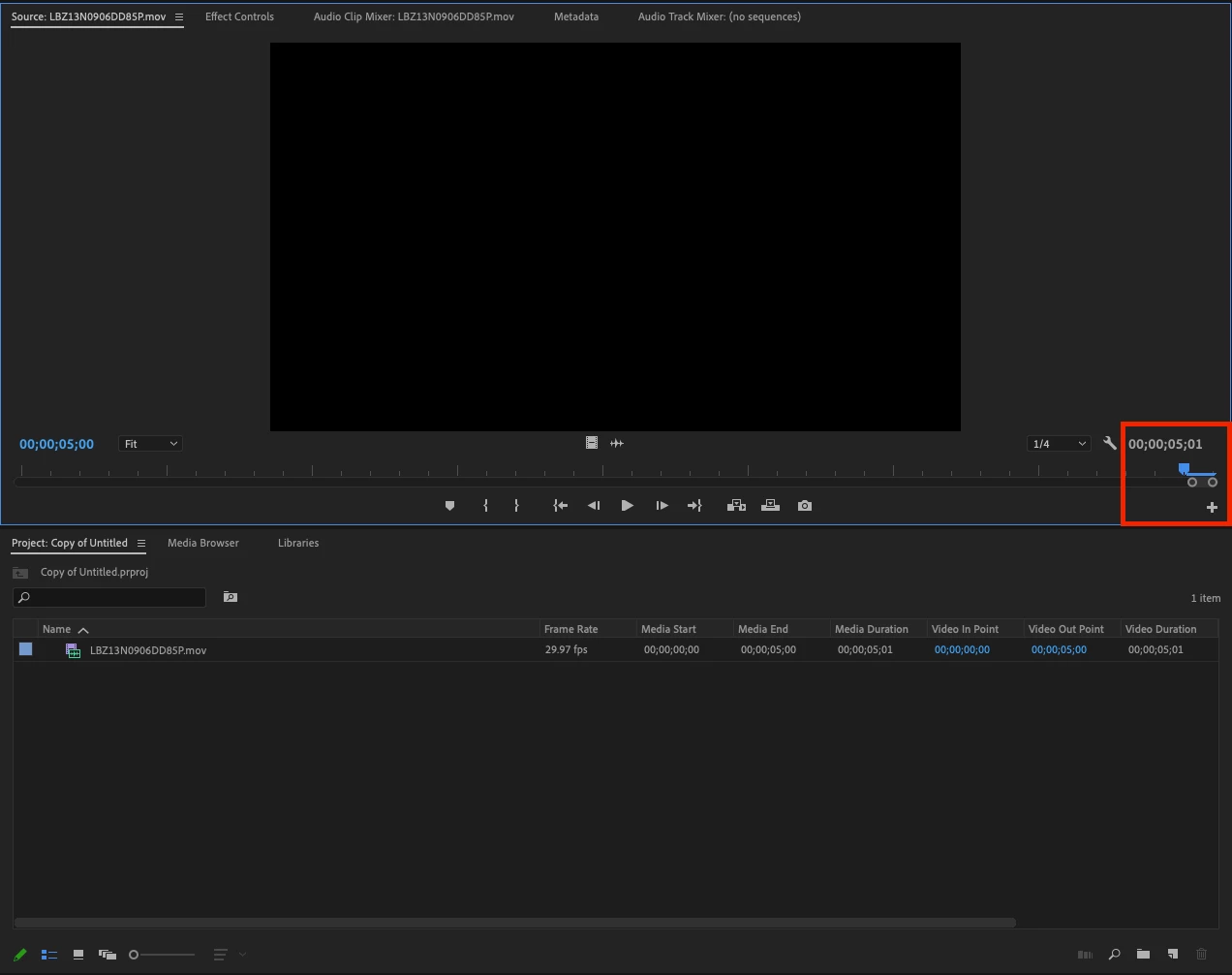

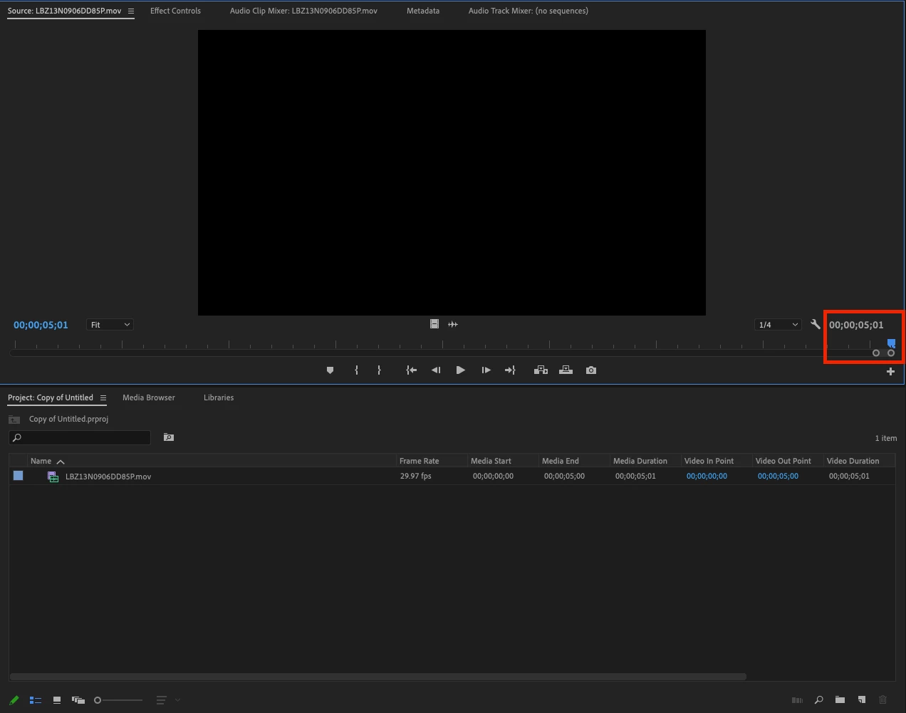

Bit of a technical question. Want to identify the correct terminolgy to describe what I'm seeing so I can explain it to others, and figure out what exactly is happening here.
In the Preview monitor I use the up and down arrow keys to navigate to the start(?) and end(?) of a video. However, when I am at the end(?) I can move the playhead over 1 more frame(?). Why does the playhead move over past the end(?) of the video if that extra frame(?) isn't present in the final export? Also, is my terminology correct here?

In short: first screenshot shows playhead on the last frame of the clip.
Second screenshot shows playhead past the last frame of the clip. Its not an extra frame.
If this were the timeline, the playhead would be on the first frame of the next clip.

  • If you are parked with the playhead using the Down Arrow, you are actually viewing the following clip, not the current clip. So, when you are at the end of the Timeline, you are either previewing the next clip, or if nothing is there, you're seeing "nothing" or Black.
I hope this makes sense, because it's a revelation that throws some people off.
This whole situation can introduce problems when using the Playhead to mark an Out point. You will be marking Out with an extra frame unintentially if you do not move left one frame before marking Out. If you then Delete, Ripple Delete, or Extract, you are then removing an added frame you probably didn't mean to. I like to use Mark Clip as that sets an Out point in the proper place (left one frame).

Thanks for the info Kevin and Ann. I am familiar with the timeline playhead behavior and setting in/out points. This question is specifically about viewing an exported video clip in the preview monitor. I was trying to determine why I can move the playhead over one more "increment".
When setting the out point in the preview monitor, I cannot place the out point the in furthest right position (when the playhead's tail is off screen). This suggests to me that the far right position is not an "extra frame", it's more of a playhead postion purely for frame value monitoring. @Kevin-Monahan, what does adobe have to say about this?
