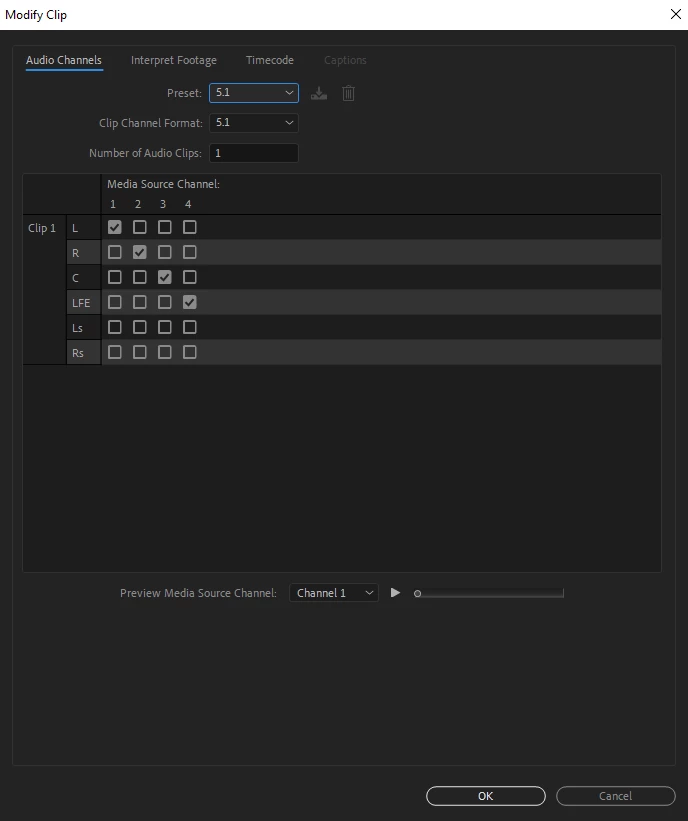

Hi, I have a question regarding importing a MXF file to Premiere Pro.
I encoded a mxf file from a mkv original source file I had, to import it and edit it in Premiere Pro. The mxf file is DNxHR 444 10 bits. The thing is that the original had 5.1 DTS audio, and when I import the file Premiere recognizes the six audio channels, but places them as independent mono channels. I've always edited with 5.1 tracks, obviously it's a lot more convenient than editing with six separate tracks, but I'm jumping on the HDR wagon and went with DNxHR 444 as video codec for editing. Seems that the mxf container doesn't support 5.1 audio as a single track, but only 6 pcm channels in this case.
Any ideas? Any way to make a single 5.1 track with the six separated ones inside Premiere, since mxf container aparently doesn't support it? I think mov container supports it, but I've yet to try a mov file with DNxHR 444 10 bit and with aac or ac3 audio and see if Premiere recognizes it as a single 5.1 track. And I really don't want to use Prores, since encoding in PC seems to be difficult, and I prefer cbr. Thanks in advance.
January 15, 2020
You could try Modify clip/ audio channels.
Right click the clip in project panel before adding to a timeline.
