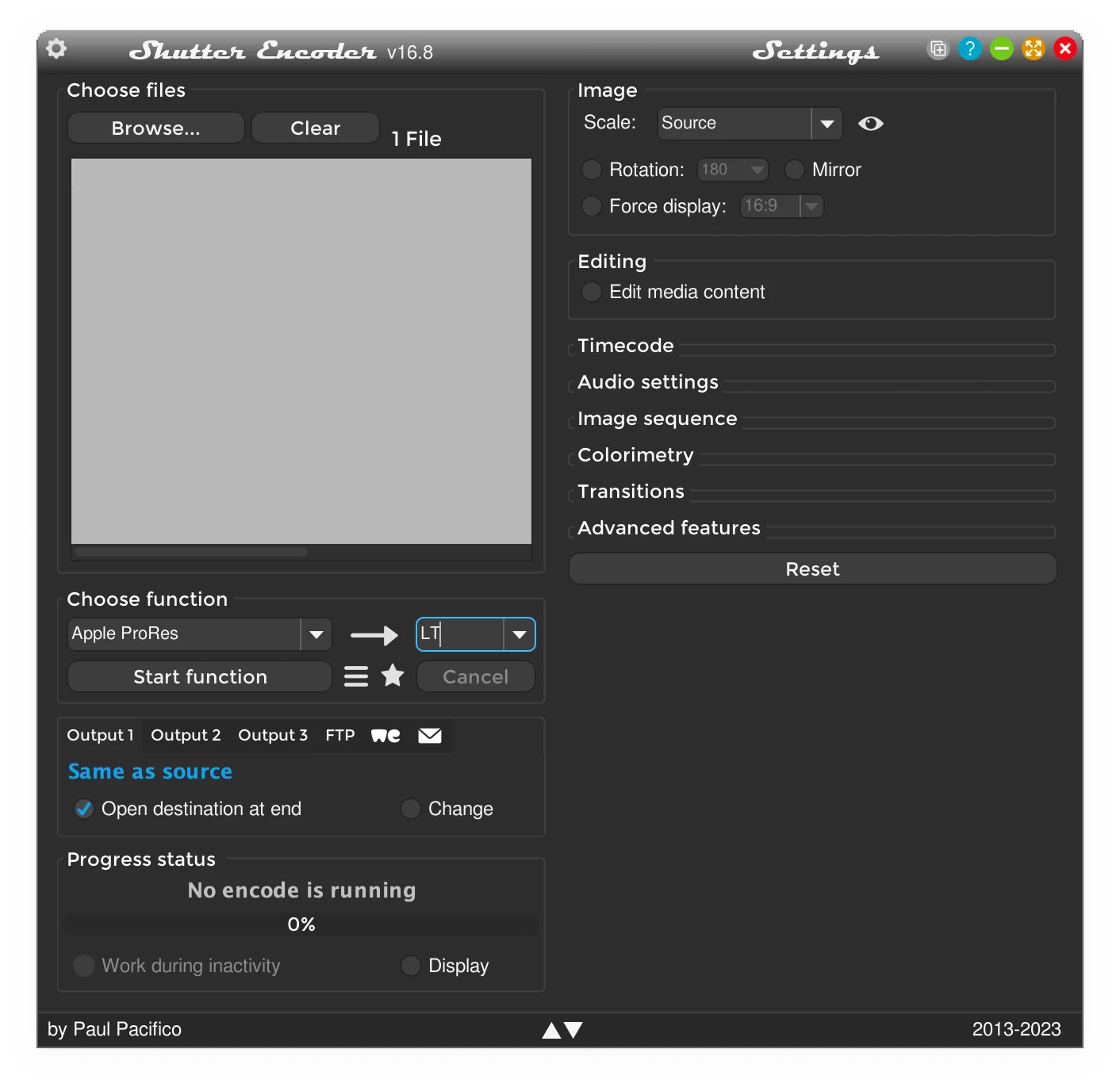

I'd try transcoding one of the H624 AVC files to a mezzanine CODEC like DNx or ProRes using Shutter Encoder.  If that imports as expected, then transcode the rest.
In Shutter Encoder, you find DNx and ProRes under "Editing codecs".  For the H264 AVC source, ProRes 422 LT should work well.
