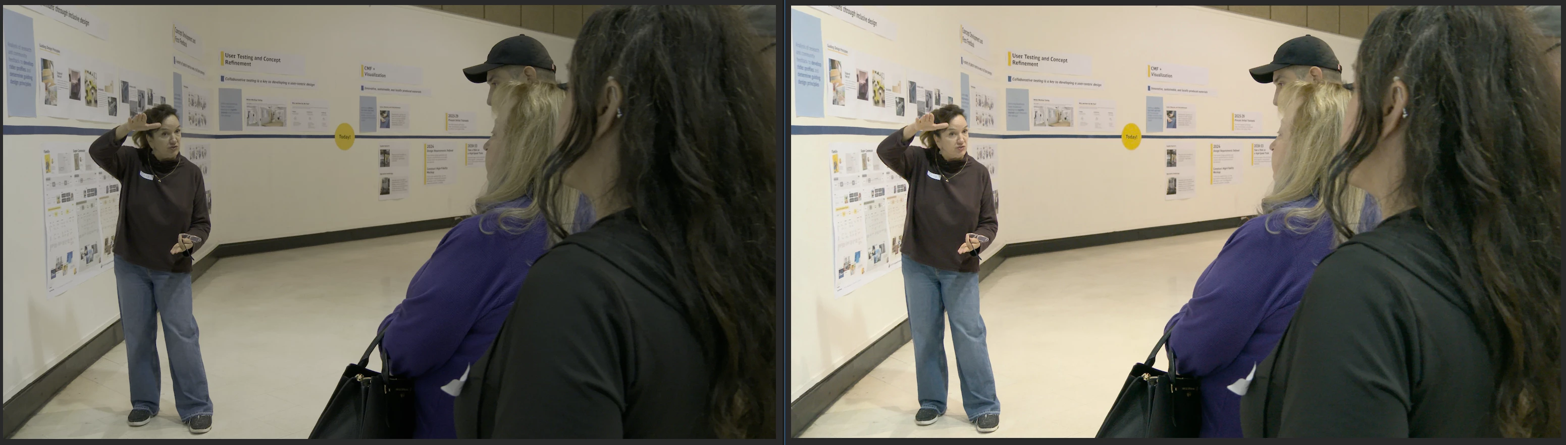

Greetings! I recently acquired a Sony PXW-z450 and upon import (Premeire Pro, fully updated) and viewing of the mxf files it looks terrible. The video looks dark, flat, lacks saturation / good color, etc. Again, brutally ugly, nowhere close to what I'm seeing when I shoot. I assume I am missing something I need to be doing but I cannot figure it out. My current work around is to heavily adjust it in my color settings, but that should not have to be done to the degree I'm adjusting. Any suggestions? Hoping there is a "ah yes.....you're missing this step" or process etc.
Note: As I mentioned I have Premiere updated and I'm shooting XAVC-L. 3840 x 2160 at 59.94 fps
You all rock, thank you so much for any suggestions!
Scott

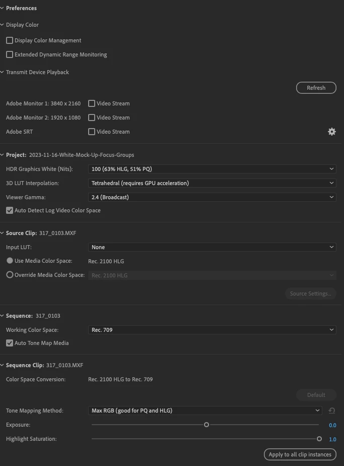

You've got a mish-mash of settings there ... so let's get that sorted.
First, you are apparently wanting to work in SDR/Rec.709 ... correct? That's your sequence CM setting.
Now going top down ... you've changed the Project graphics white to 100 ... this is a setting that only affects HDR sequences, and normally is professionaly set to the 203 nits level. Shouldn't be an issue here, but if you wanted to do an HLG or PQ sequence, that might not work too well.
You have auto-detect log on, good! ... which will catch most HDR clips, as ... virtually all actual HDR clips are log-encoded. HLG certainly is.
And if you have auto-detect log in the prefs section, and auto tonemap in the Sequence section, you normally can skip the clip section of setting a clip color space.
Did you make any changes in the tonemapping method section? Or is that what came up 'natively'?

I attached these to another response as well. Preview and program view, along with the settings. The only adjustment I have made is the timeline to Rec 709, which does help but it still looks pretty flat to me.  VERY much apprecaite your insight.

Without knowing a lot more, "we" can only say you're missing color management steps somewhere.
So ... OS/CPU/GPU and GPU driver; are you working in SDR/Rec.709 or HDR, maybe HLG?
What are your current color management settings in the Color Workspace, Lumetri panel, Settings tab?

December 7, 2023
Here's two screenshots for reference that I should have included in the post. Probably goes without saying but the left is source, right is program and then I've attached a settings screenshot as well.  As you can see I changed the timeline to Rec 709 (with no manual color correciton) and its better, but still looks really flat to me. Making further color correcting adjustments helps, but something isn't right before I get to that point.....I believe. Thanks for your response.
