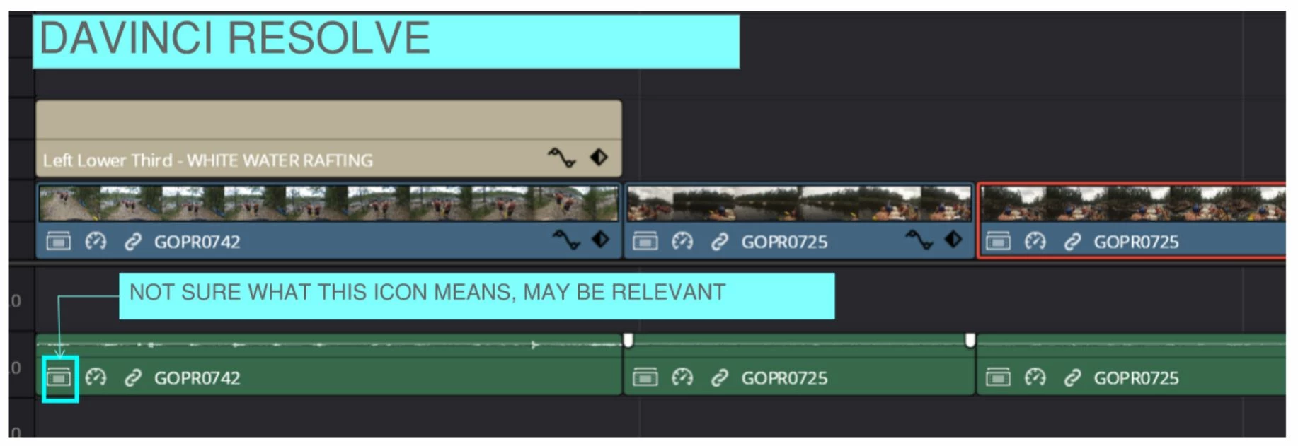

When exporting a timeline from Resolve 19 to Adobe premeire 2022 only the first video is relinkable properly.
  • The first video for multiple timelines consistently presented this issue.
  • If a different video was swapped for the first video, that new first video would be the only properly relinkable video.

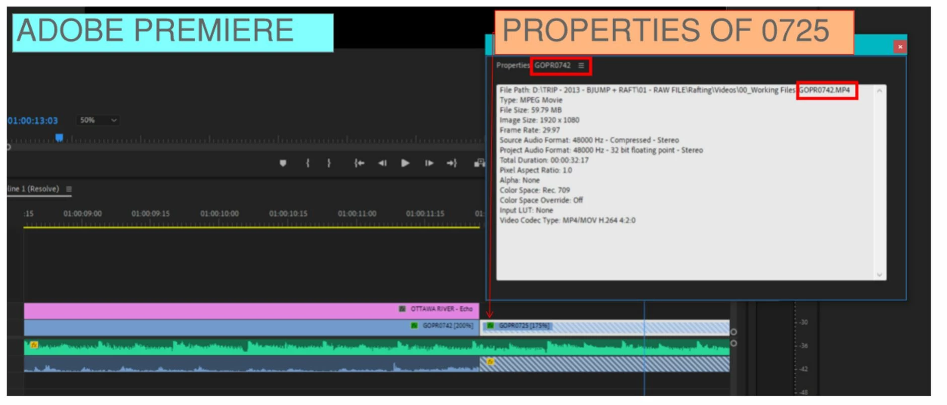

I’ve taken a screen shot below, video 725, (the second video) is linking the first video(742)
  • If I try to replace the second video(right click, replace from bin) to the properly mapped imported second video, the second video plays though the start frame is reset.
  • For context this timeline was originally exported from FCP to Resolve, destined for Adobe Premiere. The timeline in Resolve functions without any known issues. Though i did notice an icon on the Davinci timeline which may have instigated this issue
