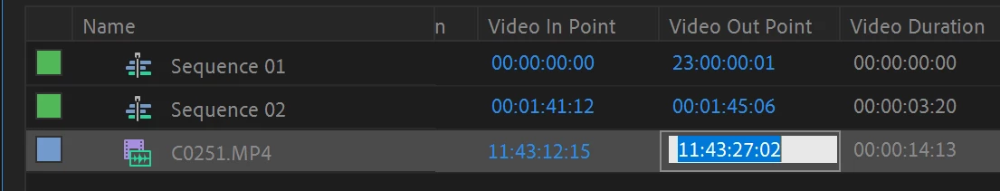

Not working as expected:
If I set in and out points of a SEQUENCE they're NOT reflected in the project panel details list and if I drag that clip into a sequence the clip WON'T be the length dictated by the in & out points, it will be the length from the beginning of the first video to the end of the last video in the sequence.
I am also UNABLE to edit the in & out points in the project list details view, they keep jumping back to what they were as you type.

Hi Thanks for the comment. And thanks for the tip about the icon view, I am finally able to change the in out for a sequence using icon view. However I still CANNOT do it in the source monitor....(which would be far more accurate!)
Moving these has no effect (either on the length listed in the project panel or the length of the sequence when dragged into anther sequence).
I can move in outs using the hover scrub in the icon view and it updates on the sequence view but it doesn't work the other way around. Any thoughts as to why?
FYI I'm finding I CAN change the in out points of a clip in list view. (see below) It just doesn't work for sequences even though it will let you type in a new number it just doesn't save! 😤
Many thanks for the help so far.
