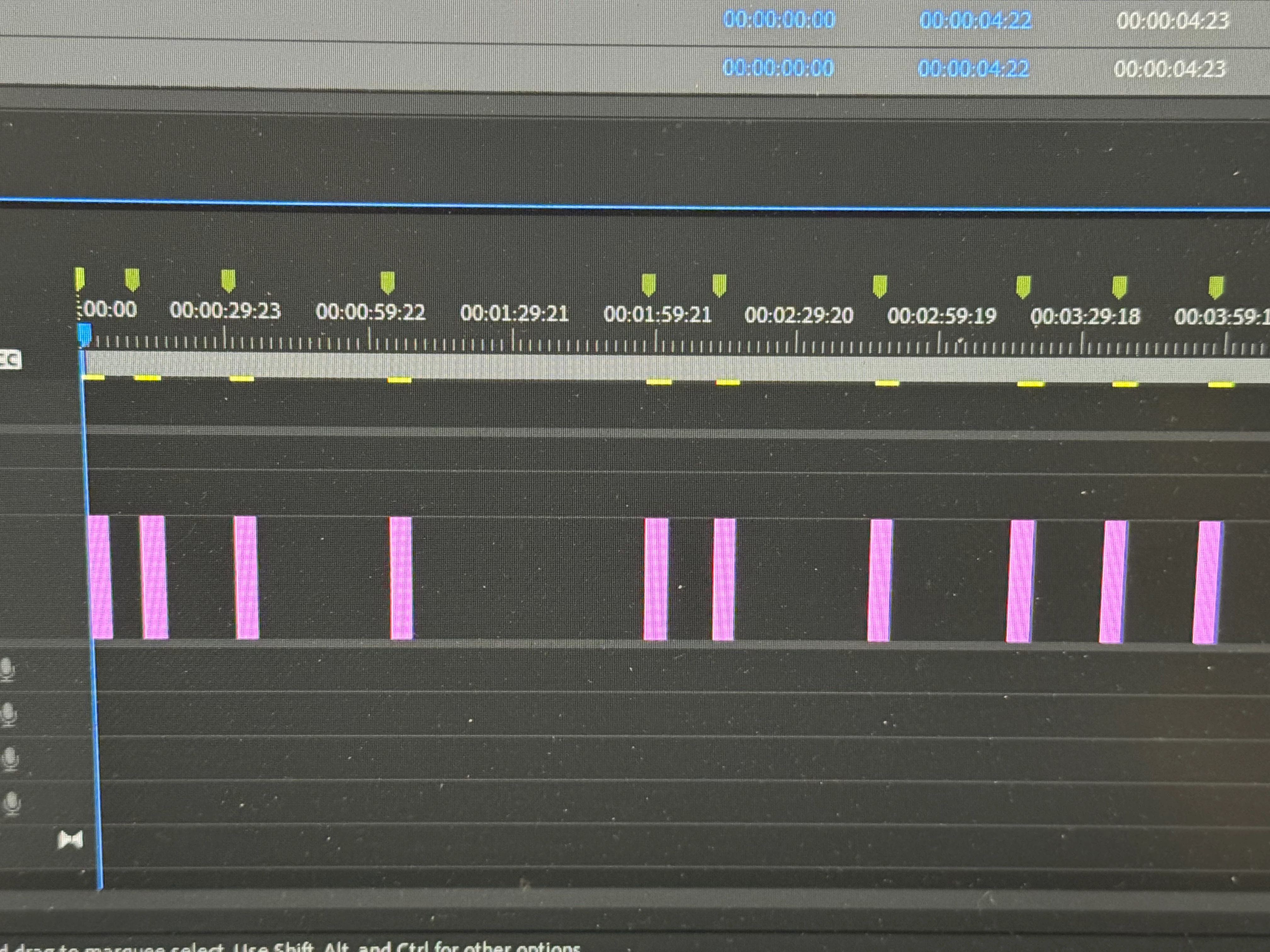

but is there a way to also adjust the length of every slide? Meaning that each slide should begin at the marker and be as long as the distance between that marker and the next one (see attached pic)
August 14, 2024
Select all the source graphics in your Project panel and choose Markers > Clear In and Out before using Automate to Sequence.
You can also do this in the timeline by selecting all your graphics, and choosing Clip > Speed/Duration and setting the maximum duration of your graphics.
