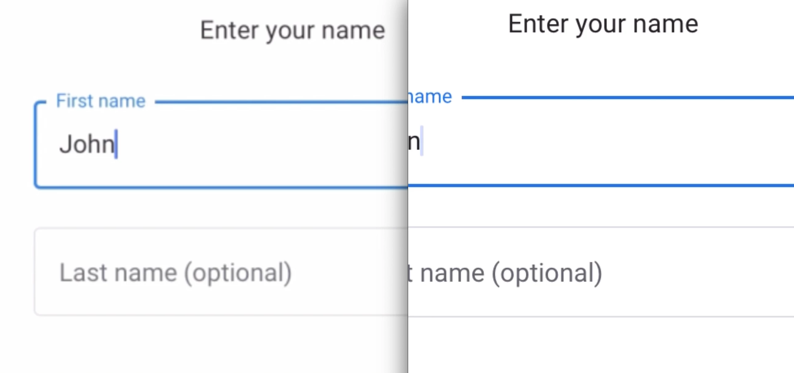

I've attached an image that I hope illustrates the issue. Blurry exported result on the left, sharp original on the right.

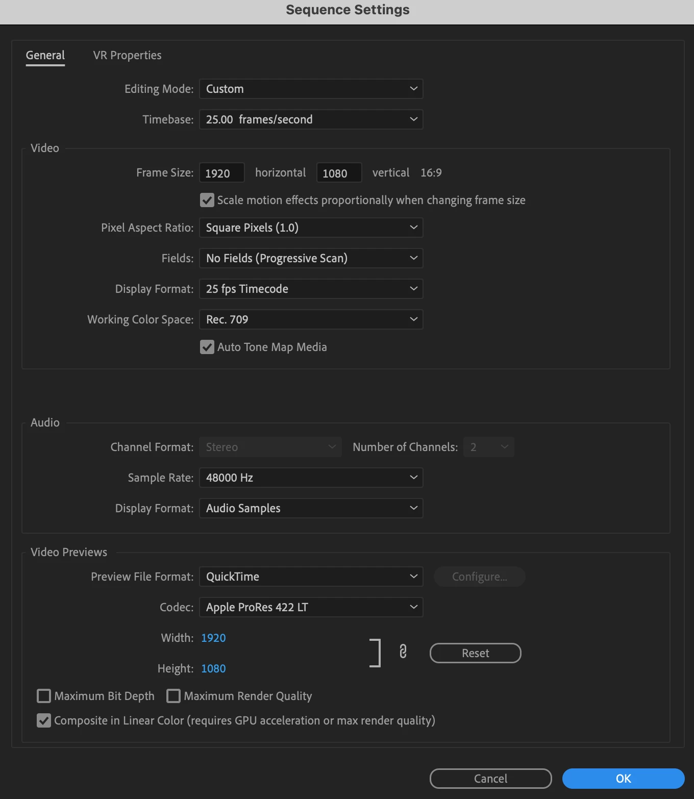

Sequence settings image also attached.

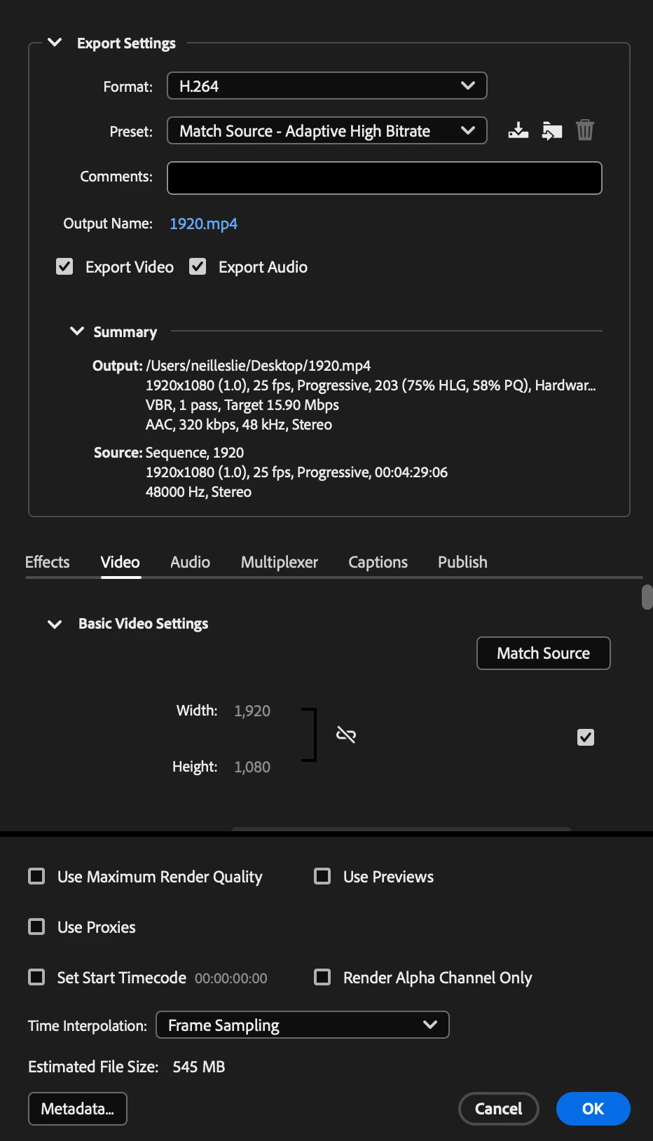

I've exported as:
Match Source - Adaptive high bit rate. Image attached.

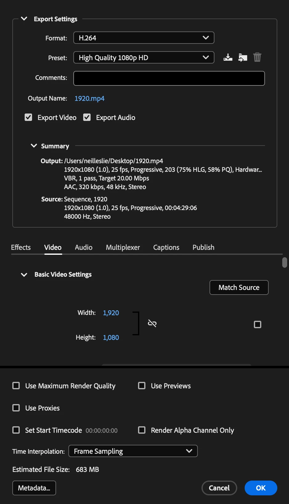

Match source high quality 1080 HD. Image attached.

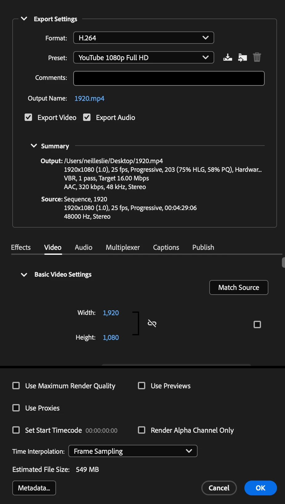

YouTube 1080 Full HD. Image attached.

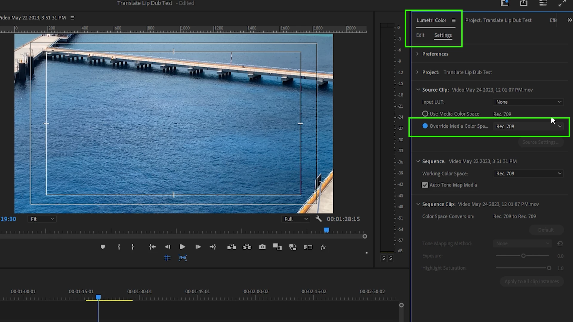

One thing you can try is selecting your clip on the timeline, then going to the Lumitri tab and select "Settings".  Then go slightly below and select override. Switch from HLG to Rec 709.

Hmm this is interesting. I've only seen this happen when there was an effect or transition that was causing the blur.
it looks like the white values and colors are slightly different in the two screen shots. The right screengrab has a more true color than the left.

Your settings look normal. This is interesting
