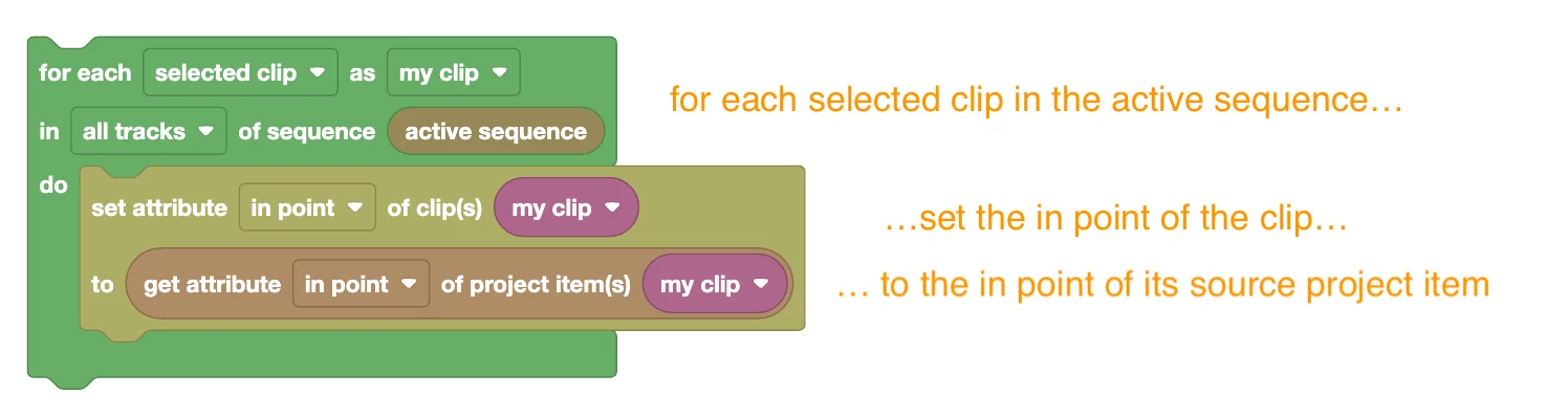

What exactly do you mean by "Specifically, for example, is there any way to make the start of the selected clip the same as it was at the in point?"
Do you mean that when the in-point of the selected clip in the sequence is different than the in-point of the source item of that clip in the source viewer then you want to update the in-point of the clip to the one of its source?
Usually the in points of both a clip and its source item are identical. Only if you have multiple clips with the same source in the sequence, I think the source item has the in and out from the last clip that has been manipulated.
If this is what you need, I just created a little sample tool with Automation Blocks  for you , which sets the in-point of all selected clips to the in-point of their respective source item:
Attached is the xml file for that block code such that you can load it into the Automation Blocks trial version, for example.
But not sure if this is really what you want, since usually the two are identical anyway.
