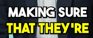

this is what i usually do:
*generate transcript then create captions (i do 13 characters and 2 lines)
*then "Upgrade Caption to Graphic"
*for each line in the "Graphic" i add scale and diffrenet color
so, i wanted is to create a something that add different styles to each line automaticlly so i can drag and drop it just like "text syle"
noting that each line are in the same layer in the 'Graphic'
