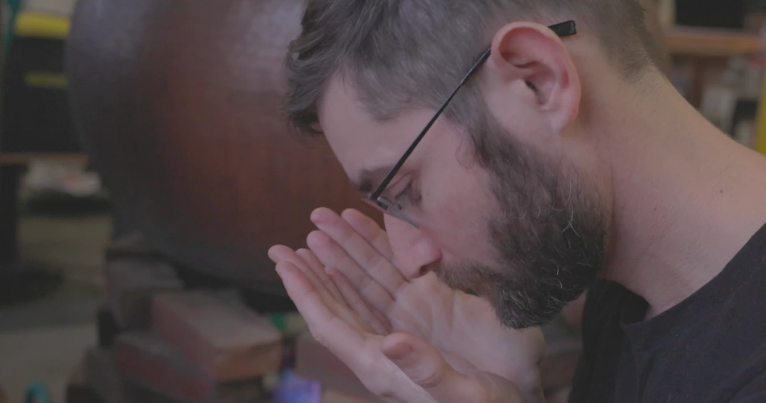

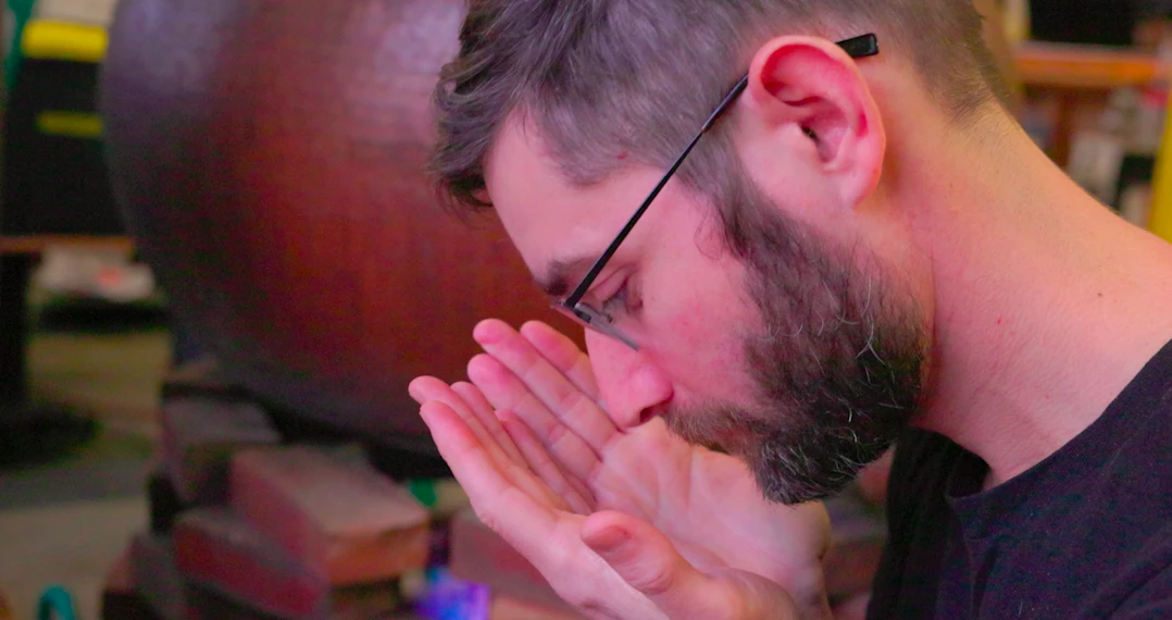

I'm editing a video I shot for a client. I shot on a Canon R5 in CLog3. I'm currently trying to color correct and color grade. In color correction, I am applying a clog3 to rec709 LUT. First thing I noticed is that the footage has a lot of pink happening. All the reds look pretty pink, and people look extra pink. And just random stuff looks pinkish. The second thing is I’ve noticed a lot of what I think is banding? More noticeable on some clips than others, but essentially it’ll go from green to pink and there will be a TON of noise revealed. Not noticeable on the flat footage. I've tried a different CLog3 to Rec. 709 LUT, I've tried reducing the intensity of the LUT, but nothing really makes a strong difference. I've attached before and after screenshots of a clip with and without the LUT applied, at 100% intensity. I've also attached a video of the weird green and pink flickering happening.

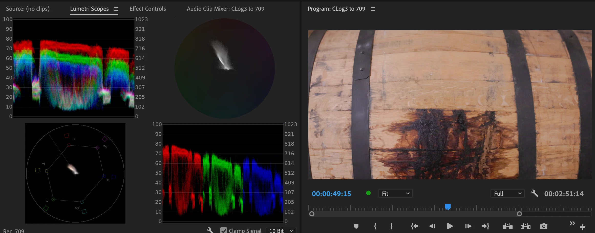

Next ... I had to check your scopes for that flicker, as I couldn't see it in the image. And thanks for including the scopes, you can see it in the upper left waveform quite clearly.
What I think this may well be is the light source of the image itself. I've seen this sort of thing with a number of different "modern" lights. Having a flicker of one direction with an LED bulb, while a supposedly clean daylight flourescent gives a different color. And like this, they flicker in/out on a regular basis due to the nature of the electrical current (frequency) and the nature of the bulb.
There's a plugin that can help with this by RE:Vision Effects ... that's the only solution I've got. And yes, this is maddening. Frustrating.

Regarding the exaggerated pinks overall -- I switched to the official canon LUT and it was much better.
The green/pink flickering is still happening in all the shots it was happening in before. I am using Premiere Pro v22.2.0 (Build 128), and the color space of the sequence is Rec 709. It is in a 23.976 fps timebase and display format as my interviews are in 23.976.
Here are the properties of one of the clips that is flickering:
Type: MPEG Movie File Size: 475.08 MB Image Size: 1920 x 1080 Frame Rate: 59.94 Source Audio Format: 48000 Hz - Compressed - Stereo Project Audio Format: 48000 Hz - 32 bit floating point - Stereo Total Duration: 00;00;17;16 Pixel Aspect Ratio: 1.0 Alpha: None Color Space: Rec. 709 Color Space Override: Off Input LUT: None Video Codec Type: HEVC 10 bit 4:2:2
Could it be something with frame rates? The clip is slowed down to 50% so it's at 29.97, but I have almost all of my b-roll in that same exact format and slowed down and the flickering isn't happening.
anour.esaAuthor
April 12, 2022
Here are screenshots of one frame where the tint looks pink, and the next where it flickers to green. The effect is most prominent in the shadows, particularly the barrel rings on the right side.
