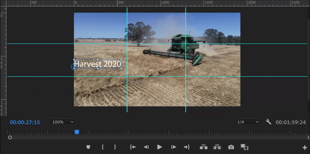

Hi!
I've recently started using Premier's Rulers & Guides to align some text; however, I'm getting some baffling issues. I'm using Version 14.7.0 (Build 23).
Ruler Positioning Issue ('Add Guide' box)

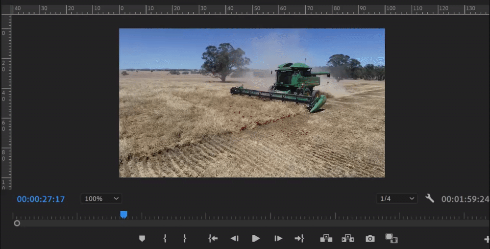

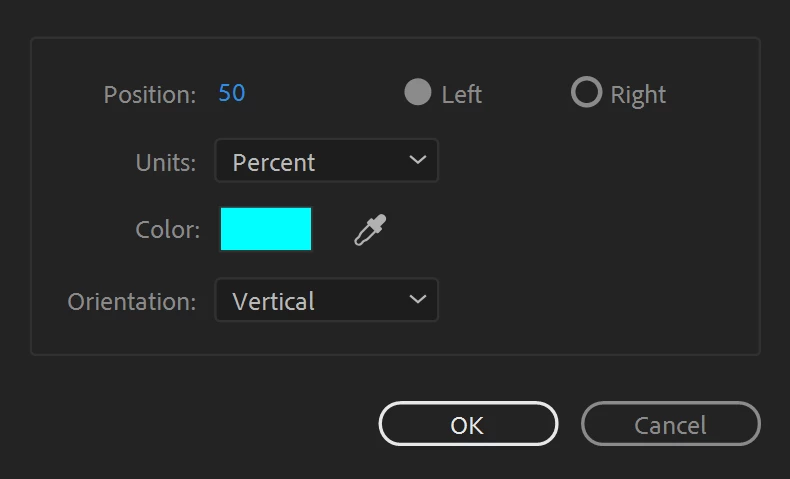

When right-clicking on a ruler and clicking 'Add Guide' and setting it to create a vertical guide at 50% (which should be the centre of the video clip displayed), it instead places it on the far right side (where it should be 100%).
This is how I had it set:
And this is the result:
This is even more confusing since it displays 100% on the ruler.
The same thing happens when using the rulers in pixels (setting it to 500px puts the guide at 1000px according to the ruler)
Ruler Positioning Issue (Dragging from Ruler)

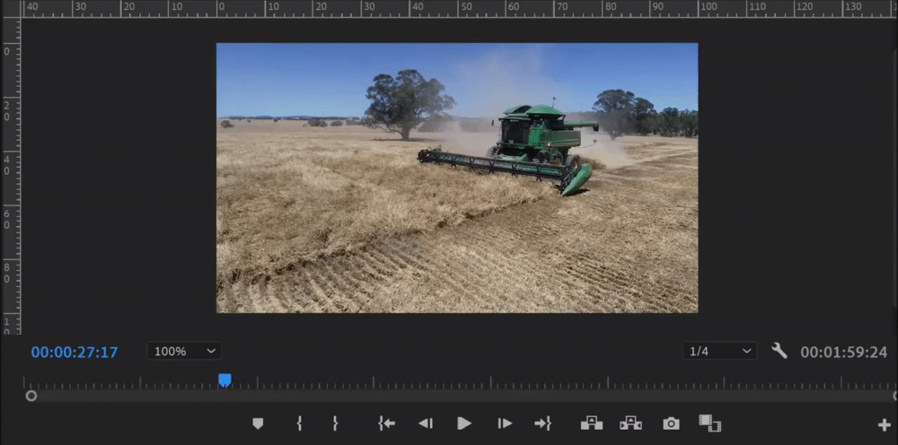

Similar to what happens when using the 'Add Guide' menu, when dragging the guides out from the rulers, the percentage displayed in the grey box is exactly half of what it should be:
Why does the guide say it is at 25% when aligned with 50% (and the centre of the video) on the rulers?
Similarly, why is the entire width of the video shown as 50% instead of 100%?
Snapping Issue
Once placing guides on the display, they don't seem to snap correctly either. As an example, I've positioned guides at approximate visual thirds and am attempting to align the 'Harvest 2020' text to one of them. The text does not snap to the guides, but instead, I have a lot of other 'snap points' which have nothing to do with the guides.
I feel like all of these issues are all interlinked. Any suggestions for a fix are highly appreciated.

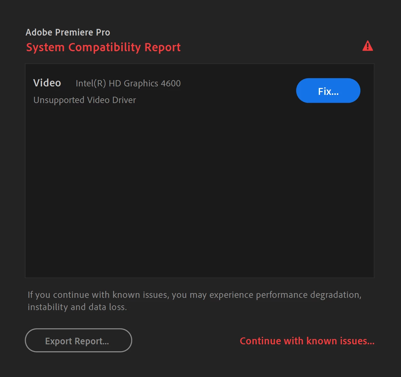

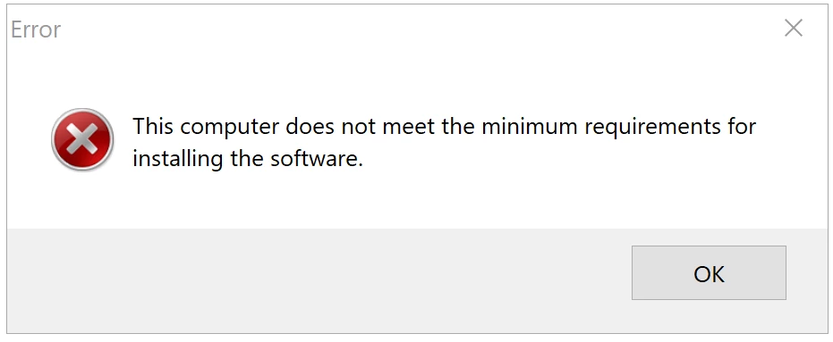

Side note: I do receive a 'System Compatability Report' dialogue when first opening Premiere to do with my graphics drivers saying they are unsupported (even though they are fully updated), and the driver recommended by Adobe does not install. Not sure if this is related or not - if it is, a fix for this would be handy.
This is the error message received when installing the driver recommended by Adobe:

And ... that compatibility warning may be involved. The Intel 4600 is a Haswell generation chip from 2013, the "equivalent" tech in a full GPU is the GTX710m, and that is also long outdated. No drivers for the 710m are available that will work with Pr2020, and I doubt the Intel4600 updates adequately also.
I'm not the power expert here on such things, I defer to a couple others for that sort of thing. We'll see if I can summon one  ... hocus pocus abracadabra, is @RjL190365 available?

Your program monitor is set for 100 percent in all the images, and Premiere is putting the guide at 50% of the image not the screen.
Set that left-side box to "Fit" instead, and you'll have the entire image showing in the monitor panel, and your guides will show correctly.
"100%" btw means you're seeing pixels one to one ... one image pixel to one screen pixel. It's a great way to zoom in on details, but you of course aren't seeing the whole image.
Neil
Everyone's mileage always varies ...
Sonia8925
Sonia8925Author
January 4, 2021
Hi Neil,

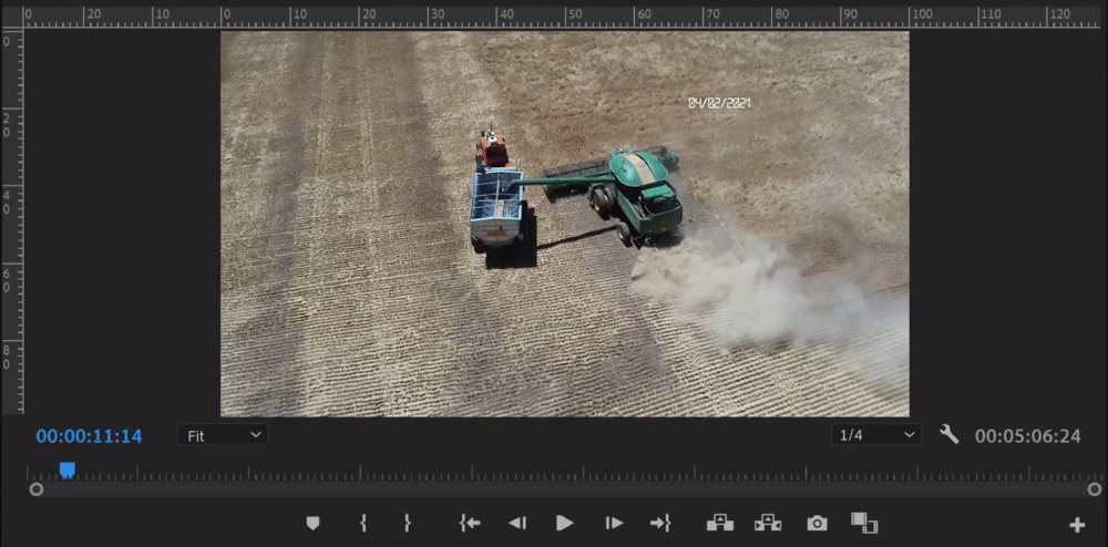

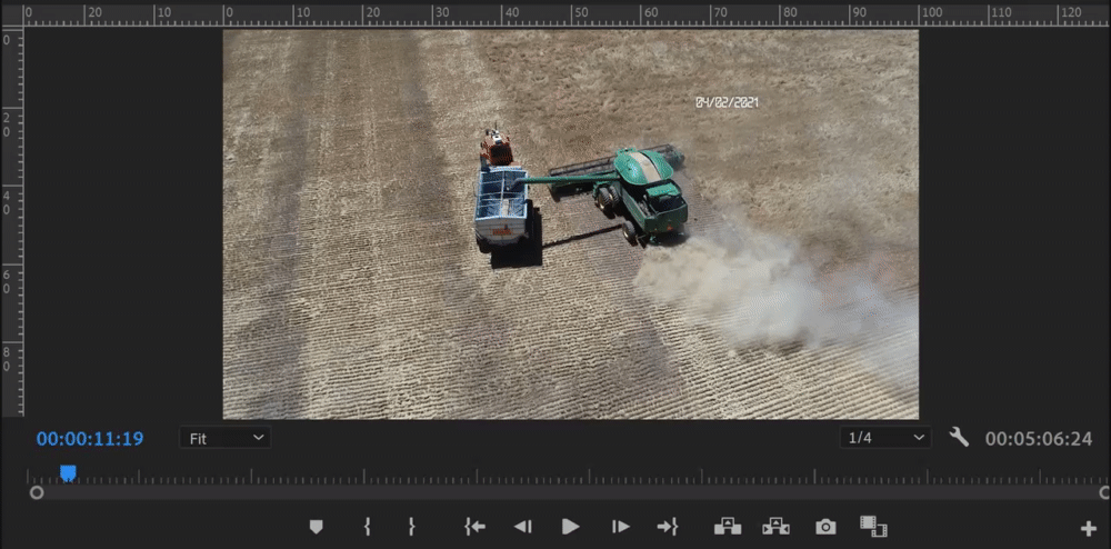

Thanks for your quick response. The entire image was showing in the program monitor, but I changed it to 'Fit' as you suggested and the same issue was present.
As seen here, the guide (when set to 50%) still appears on the far right-hand side of the video:
As another test, I've added a guide at 66% (with the zoom set to 'fit'). The guide should appear at about two thirds, but instead, it is off the side of the image and I had to change the zoom to even see the guide.
I'd greatly appreciate any other suggestions.
