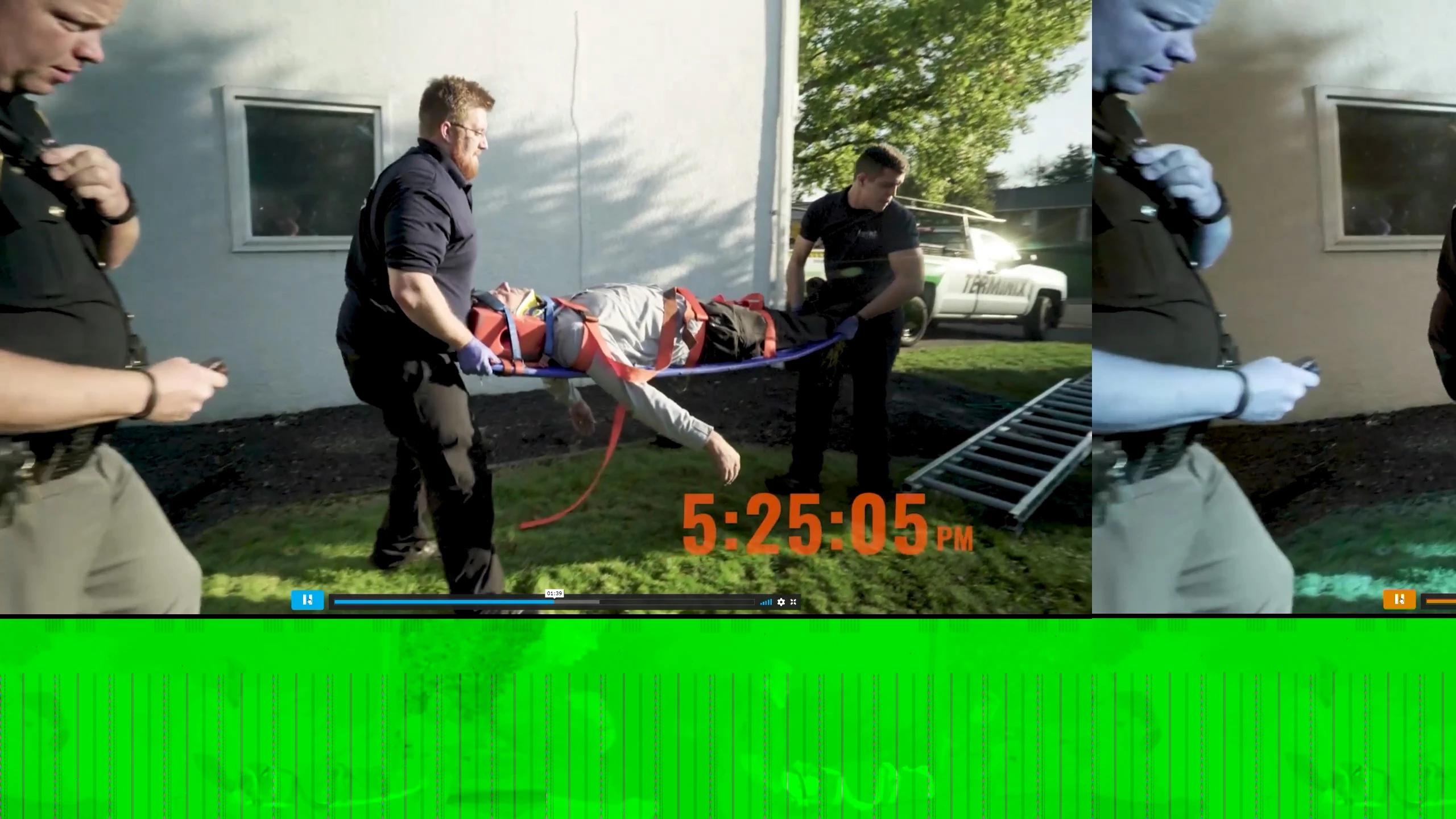

I have two MP4 clips that I want to join together to make a new video.  Clip 1 is my own creation.  Clip 2 came from someone else.
When I put them on the timeline they play just fine together.  When I render the timeline the images in all the frames of Clip 2 become smaller and split the image with a large green bar filling the lower part of the screen.   I've attached an image showing the green bar.
I tried starting a new project with just Clip 2 and I get the same result when attempting to render.  I've done this many times with MP4 clips that I've created but I'm missing something with this particular clip and not recognizing the problem.
Any ideas??
Correct answer John T Smith
>Frame rate mode : Variable
PPro does not play well with that kind of file convert to constant frame rate with https://handbrake.fr/ open source transcoder/converter

Thank you.  Good to know.  Converting it to constant frame fixed the problem.  I appreciate your help.

MP4 is a wrapper, what is inside YOUR wrapper - Exactly what is INSIDE the video you are editing?
Report back with the codec details of your file, use the program below
Free program to get file information for PC/Mac http://mediaarea.net/en/MediaInfo/Download
- when you analyze your file in MediaInfo and post a screen shot in the forum, do so in TREE view
- post your information IN your message, not as an attachment that someone would have to download
You need to compare the two files to see what is different

Here are the two files evaluated with MediaInfo.  The first is the one that produces the green bar when rendered.
