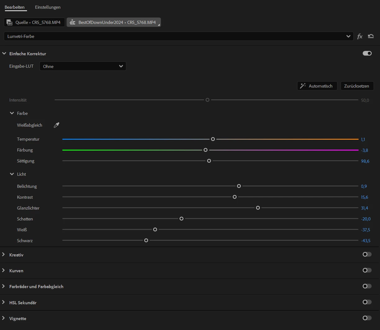

Nothing I can say. I don't need the Export settings. I need the color management settings in the Lumetri panel Settings tab. As the key to all color space issues in Premiere and between Premiere and Me.

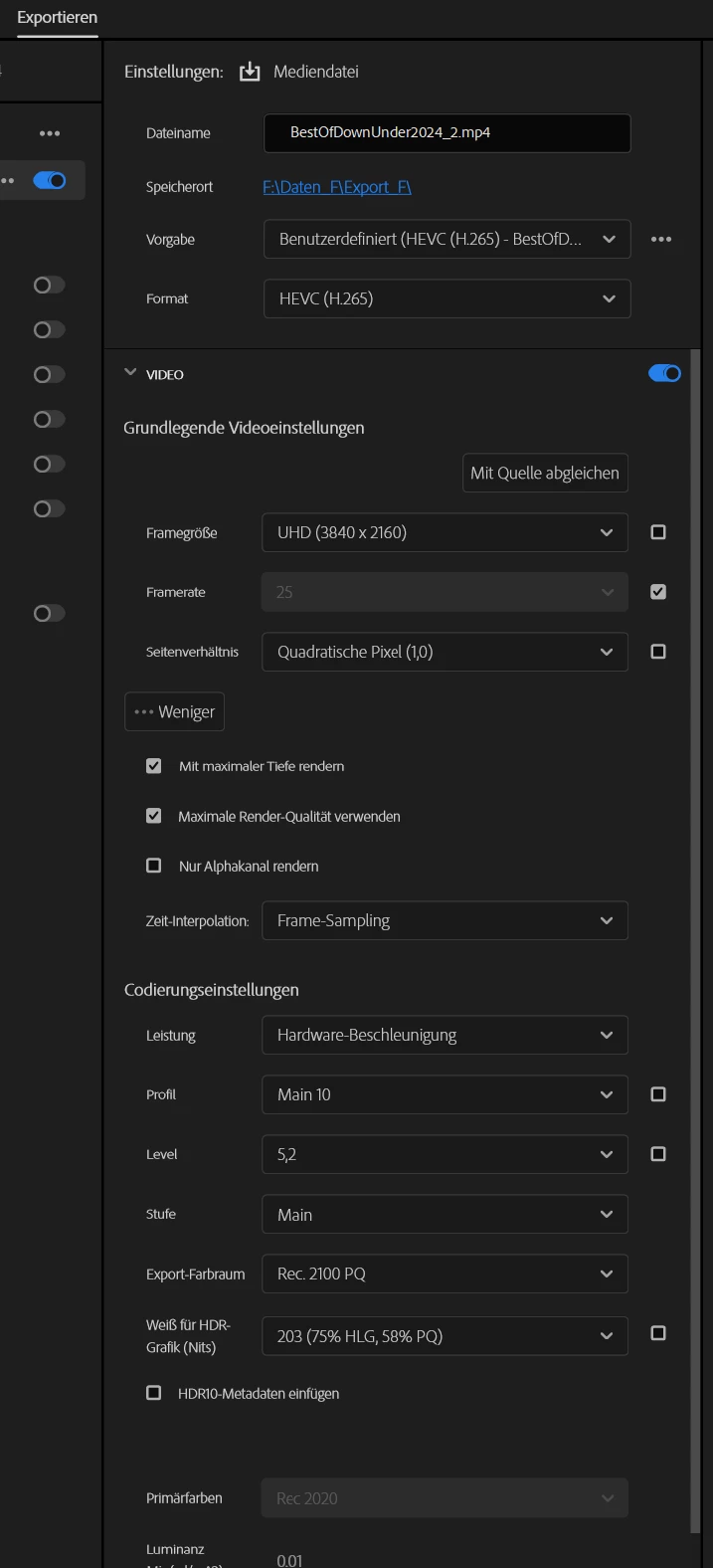

These are the xport setting:

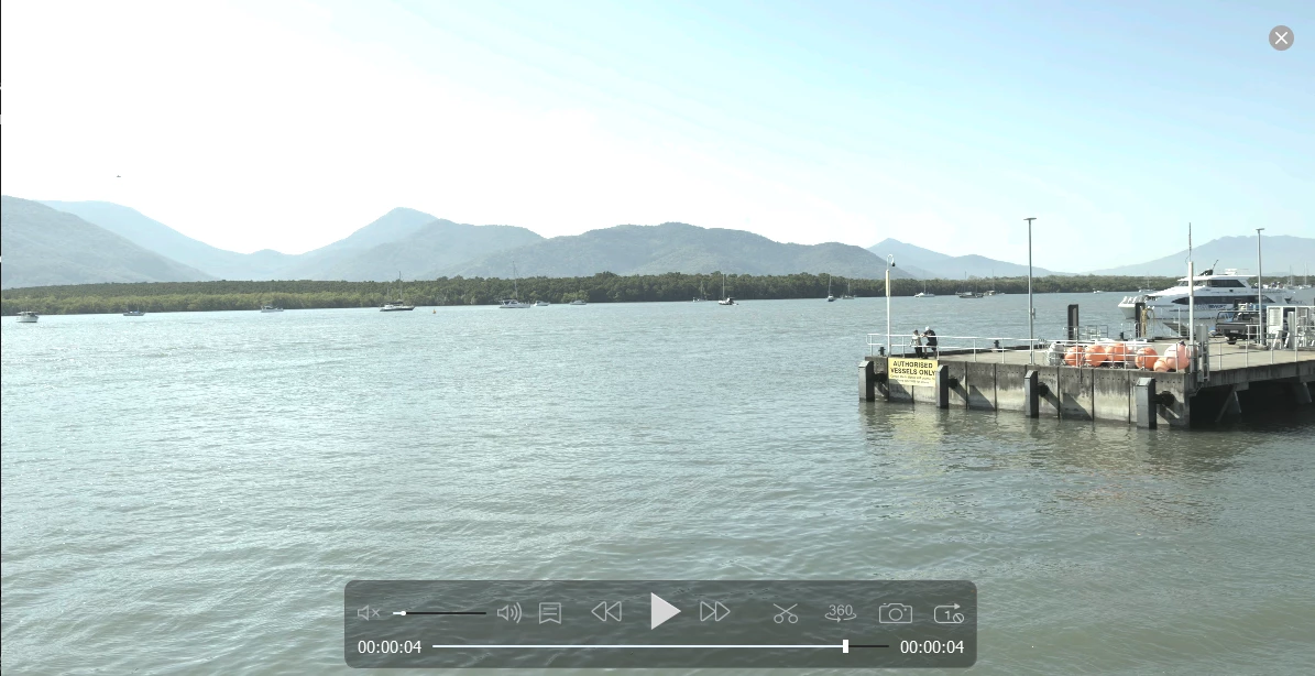

Here is an export with ME:

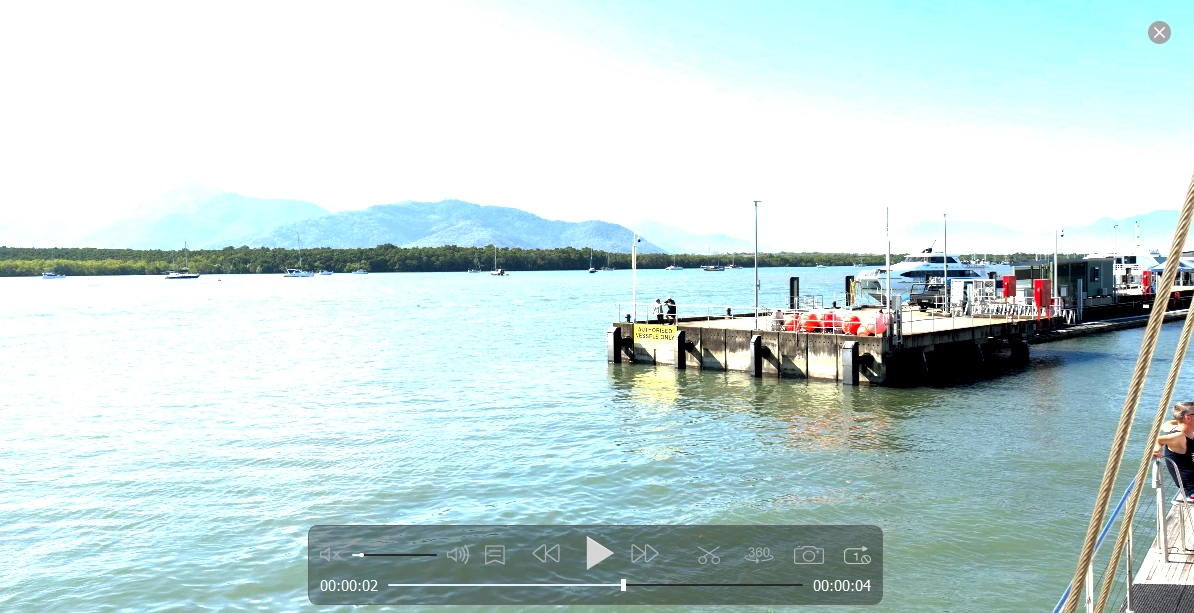

And here directly from PP:

Knowing both your total color management settings as you are using them, and exactly what you start with, and exactly what you wish to export, is essential to even offering any suggestions.
Screengrabs of the entire Lumetri panel Settings tab, the color management tab, with all sections twirled open, would be good. Drag/drop right onto the text reply box.
And give good written descriptions of your media, sequence, and export desires.
