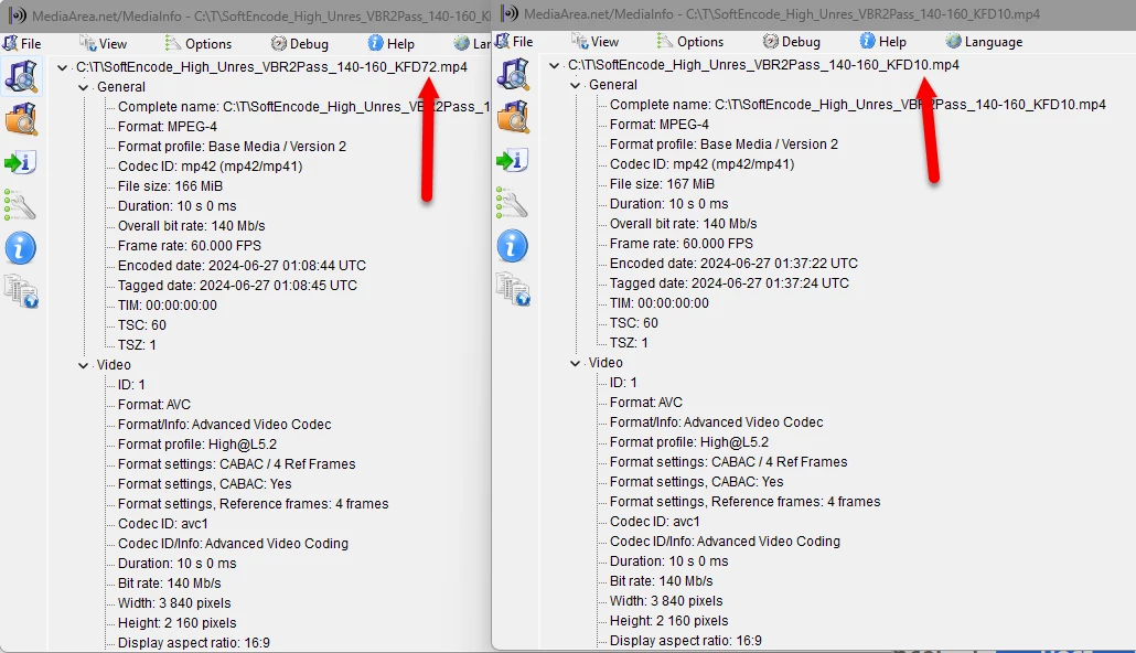

MyerPj
June 27, 2024
You can use the free MediaInfo program to get info on your clips. Get the program from the link below and using the 'Tree' view post a screenshot of your clip info: https://mediaarea.net/en/MediaInfo/Download
The 10 and 72 looked pretty much identical with MediaInfo in Tree view
FYI: I doubt you get anything better with 2 pass
