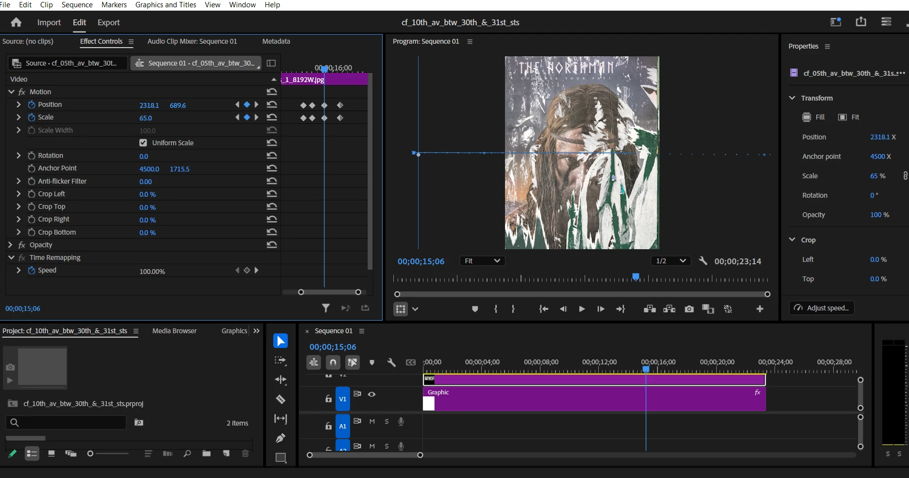

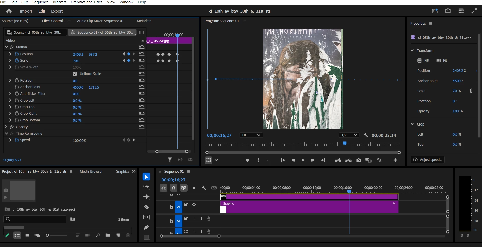

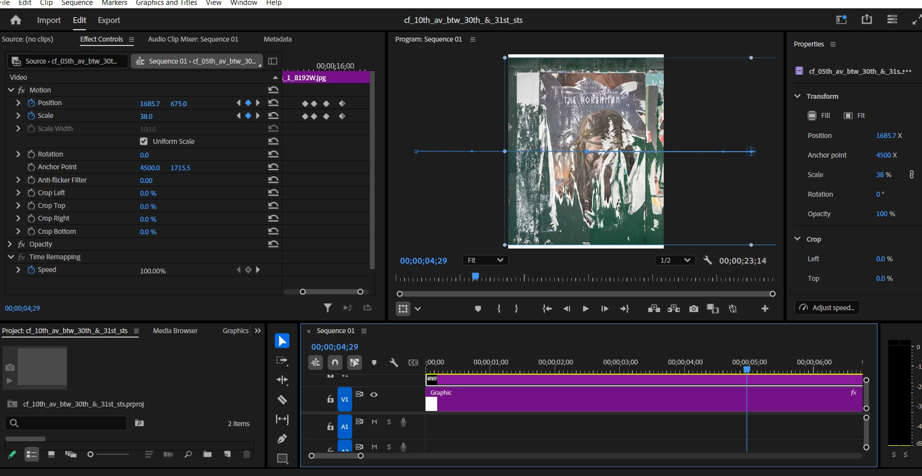

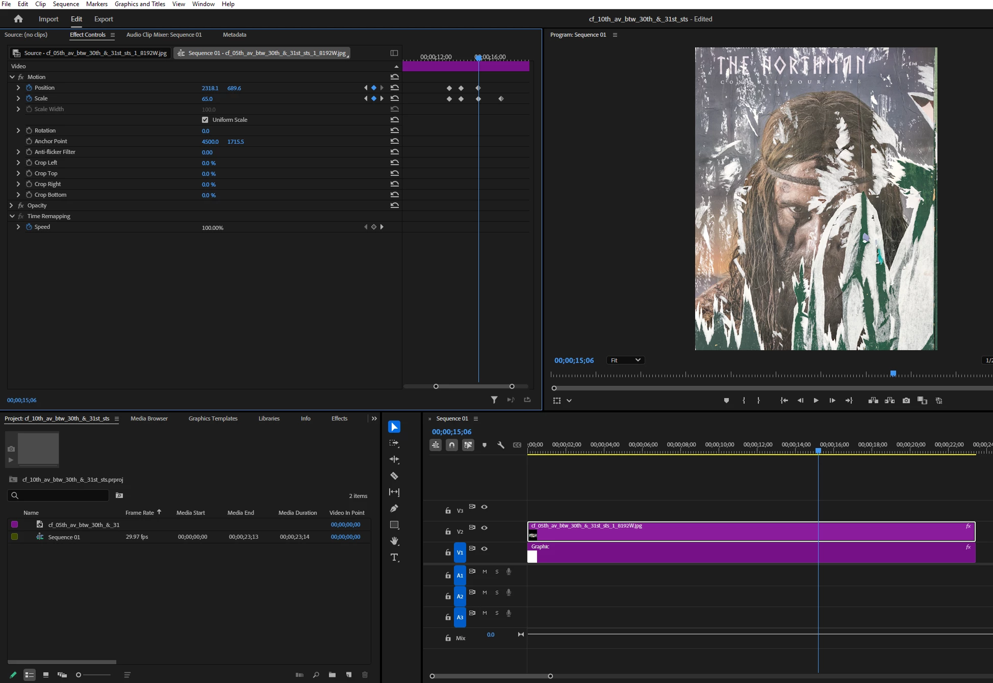

I want to zoom in slightly without panning - but am having problems.  In the 1st screen shot, my playhead is on the keyframe where i want the zoom to start.  The 2d screenshot shows the next set of keyframes with a scale of 70 increased from the previous scale of 65.  However, the image has drifted to the left, so that the man's head is no longer centered.  I thought if I clicked on Motion while on the position of the 2d set of keyframes and centered the man's head, this would achieve what I want, but instead, there is further drift between the 2 sets of keyframes, with the frame drifting first to the right and then to the left before landing on the 2d set of keyframes.  What am I doing wrong and how do I get a dead on zoom from the 1st set of keyframes to the 2d?  Thanks.

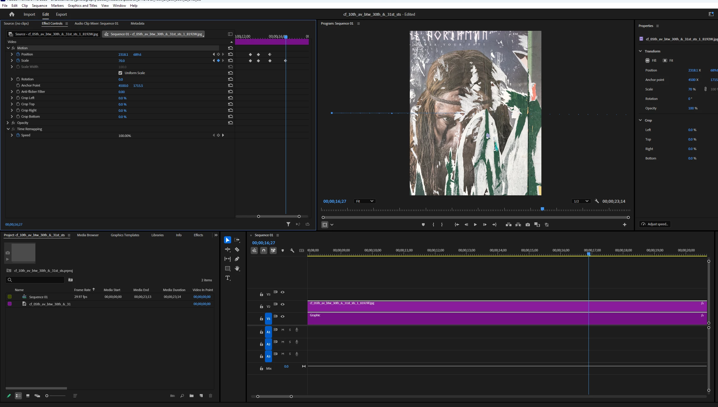

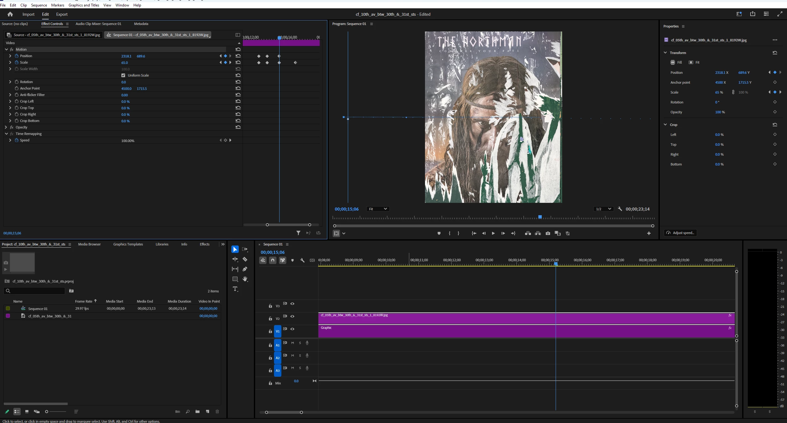

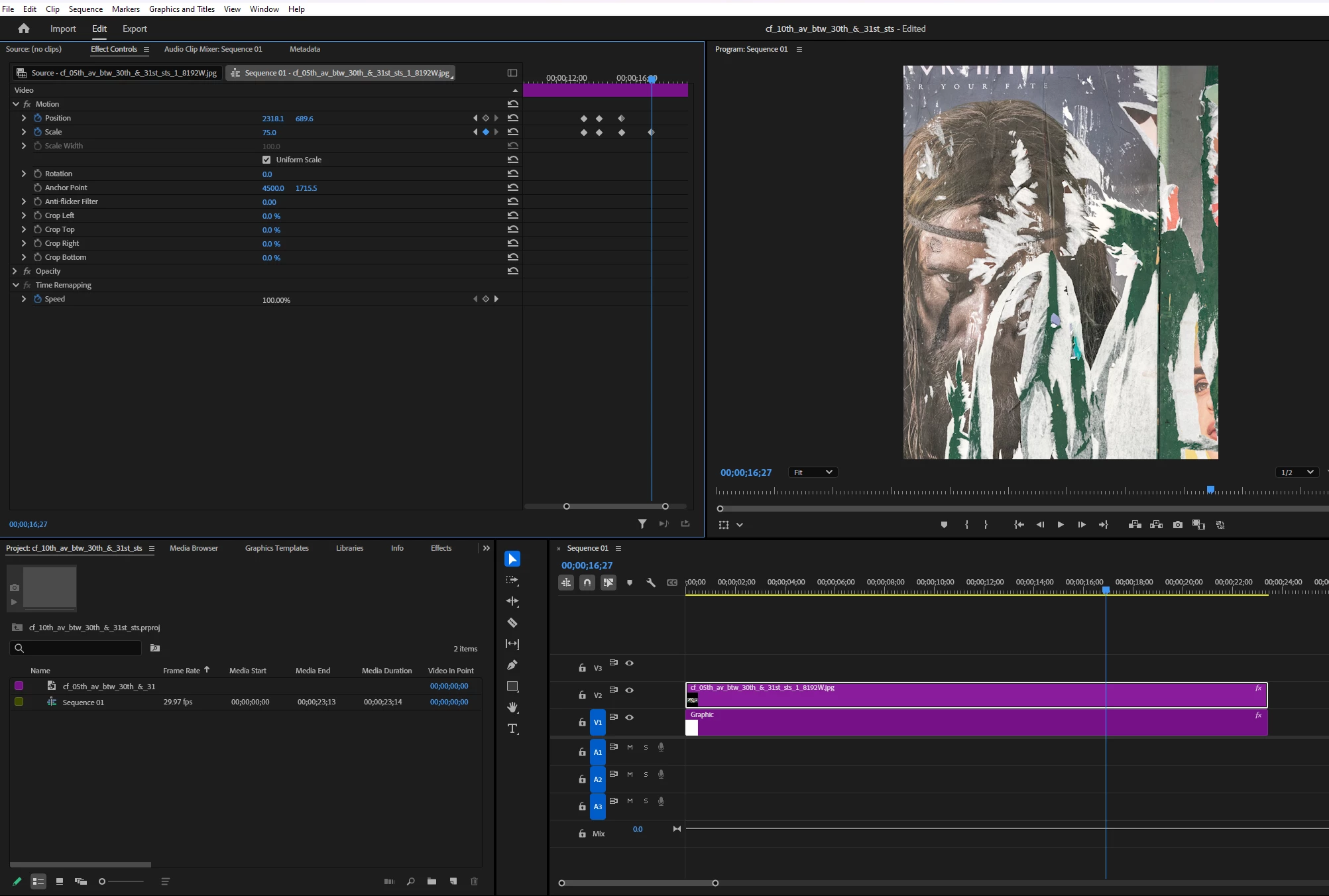

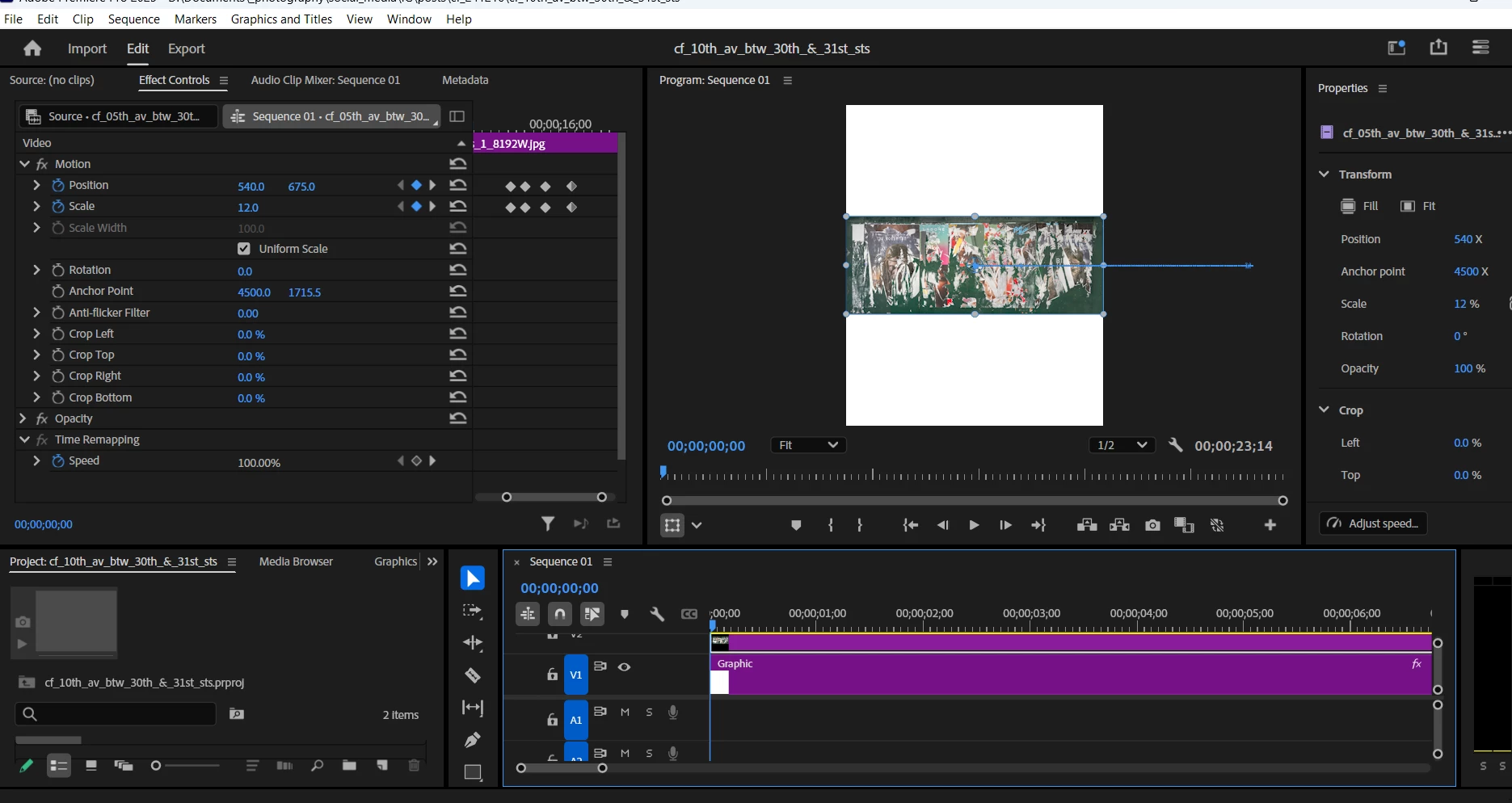

Thank you for your information.  I wonder if my workflow would be different given that I am animating a single image.  I am making an Instagram reel and using a very large image with an aspect ratio of approx. 3:1.  I start out showing the entire image so it fills the frame from side to side, at 12% scale, then zoom in so that it fills the frame from top to bottom, at 38% scale.  I then pan from left to right across the image and can see the anchor point moving, eventually it leaves the screen entirely.  I want to pan to sections of the image, then zoom briefly in, then repeat that in other areas.  I want the zoom to be dead on.  What I am experiencing instead is "drift," with the image both panning and zooming.  I thought if I left off a position keyframe for the 2nd set of keyframes and only increased the scale, the image would only zoom but that's not happening.  See screenshots below showing the image at the 1st set of keyframes and at the 2d - the man's face is no longer centered, but towards the left side of the frame.  What's happening here?  Without putting in a position value, is the zoom using the acnhor point as a reference?  If so, how do I change it, and how do I know what to change it to?  Many thanks.
Thanks to Larry Jordan, I now know that I can't achieve the desired effect using a single clip.  Rather, if you want to zoom into the middle of a section of a larger clip, you need an acnhor point set to the middle of that clip, which is not where it will be for the larger clip.  So I created a new clip, aligned the master clip to it at the point where i want to start zommin in, using the detail clip to zoom in on.  It was a lot easier than it sounded and the results were quite good, but did take some work.

I notice your anchor point is the same in all 4 screenshots. Try using rotation, you'll see the clip moves around the anchor point.

Scaling in Premiere Pro is always centered around the clip's anchor point (the blue circle with crosshairs), and in your case, it looks like the anchor point might be off-screen.
To change this and ensure the zoom is centered, you’ll need to adjust the Position values to align the anchor point back to the center of the frame.
Dec 17, 2024 5:38 PM UTC
Thank you for your reply.  I am trying to understand more about how the anchor point works.  It looks like it is present at the point where you upload media into your project - the 1st screen shot below shows it in the center of my image when opened.  When I use Motion to zoom and pan to the image's left side, it moves off the screen to the right (2d screenshot).  So it seems to "travel" with position and (possibly?) zoom change.  By the point where I want to create a zoom in (not pan) between 2 sets of keyframes (screenshoits 3 & 4), the anchor has moved off the screen, as you note.  Do I need to "reset" the anchor at the 1st set of these keyframes to be at the center of the image?  Is there an "automatic" way to do that or do I eyeball it?  (Presumably, resetting it does not affect its prior positioning.)  Bottom line I need to know how to adjust the Position to realign the achor point back to the center of the image - but I don't know enough to do this.  Thanks for any help you can provide.
