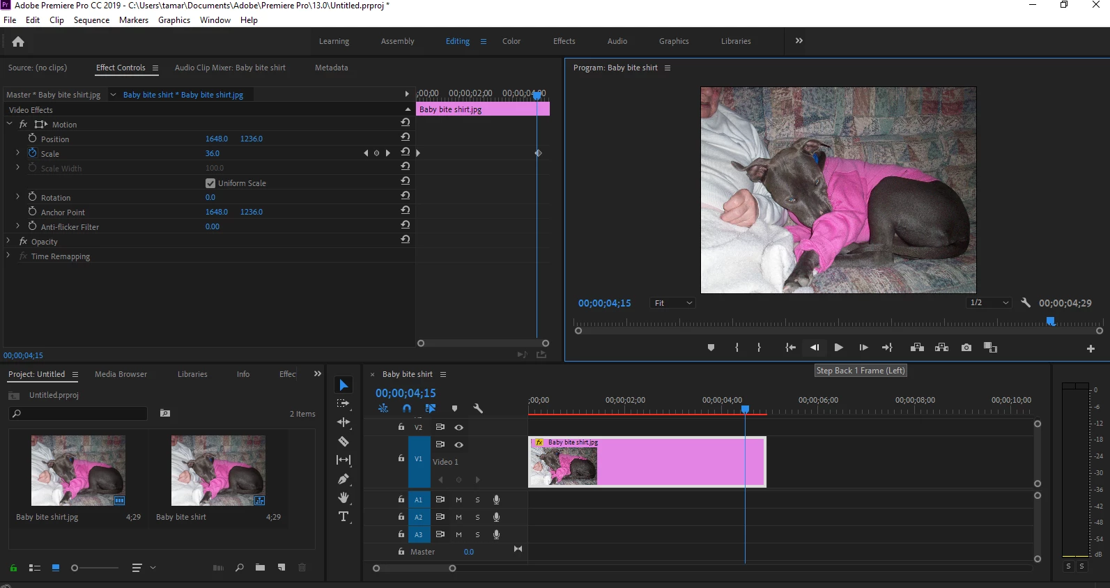

Dec 22, 2018 4:01 PM UTC
Here are some screenshots, I hope this is what you need? thanks
