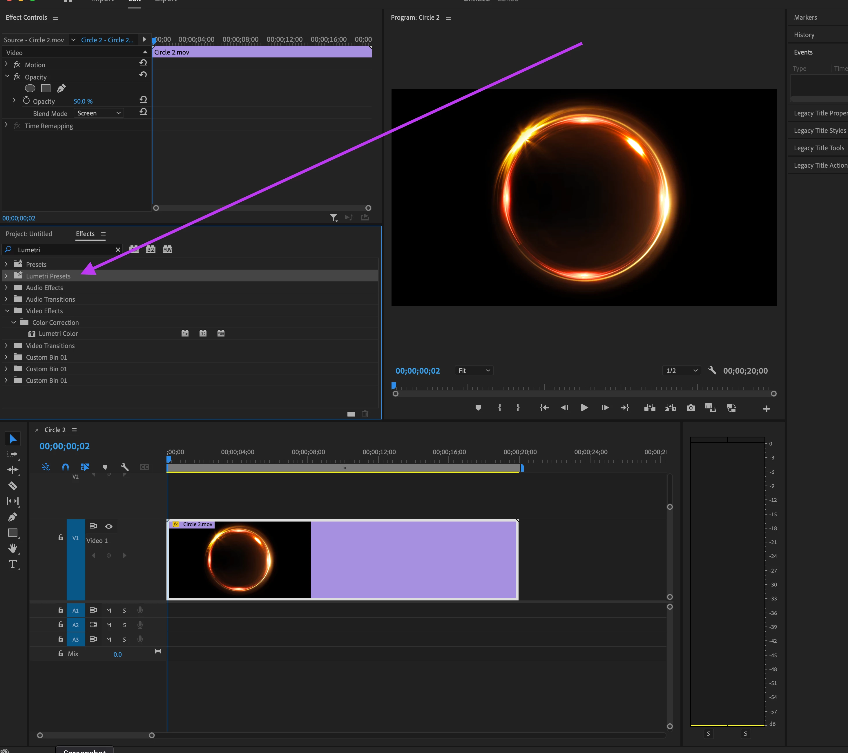

July 15, 2022
Hi Again,
In the Effects, Controls, I can't seem to see the Lumetri "color" option ?
Could you point me in the right direction pls.
Many thanks
July 20, 2022
Yes, that's the Lumetri panel.

July 15, 2022
Try this with black background graphics.
1 - select the clip on the timeline
2 - open the effect controls window in the interface
3 - you should see an option to control Opacity
4 - twirl down and you will have access to Blend Modes
5 - select Screen.
Should get rid of black and keep the glow.
