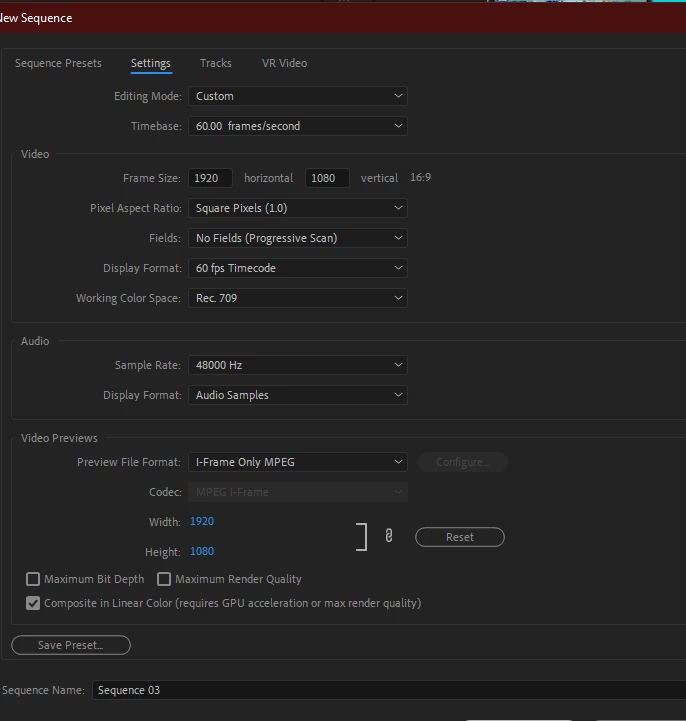

AMD Ryzen 7 3700X 8-Core, 16GB Corsair Dominator RAM, Nvidia GeForce GTX 1060 6gb GPU, Adope Premiere Pro Version 14.6.0, My 3 drives are all under 50% full, ill post a picture of my premiere settings. sorry if i forgot anything let me know what else you might need.
