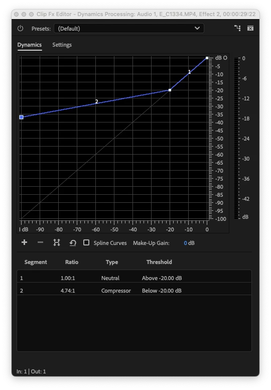

I have quickly tried out the Dynamics Processing effect that is mentioned above. This did help a little bit but I think I need to read a bit more on setting up this effect to understand what I am doing when applying the settings to maximise the benefits.
I'll investigate more and look up a tutorial.

I'll try the Dynamics Processing approach as well @Elijah31962510mxso  - again I've not used this yet.
Will report back how I get on
November 10, 2024
JonesVid,
Have you tried using Dynamics Processing? This is a rather extreme use of the effect, but it does what I think you're looking for, which is to apply make-up gain to anything below a certain threshold. You could achieve the same effect with paralell compression– but that's what Dynamics Processing basically is.
