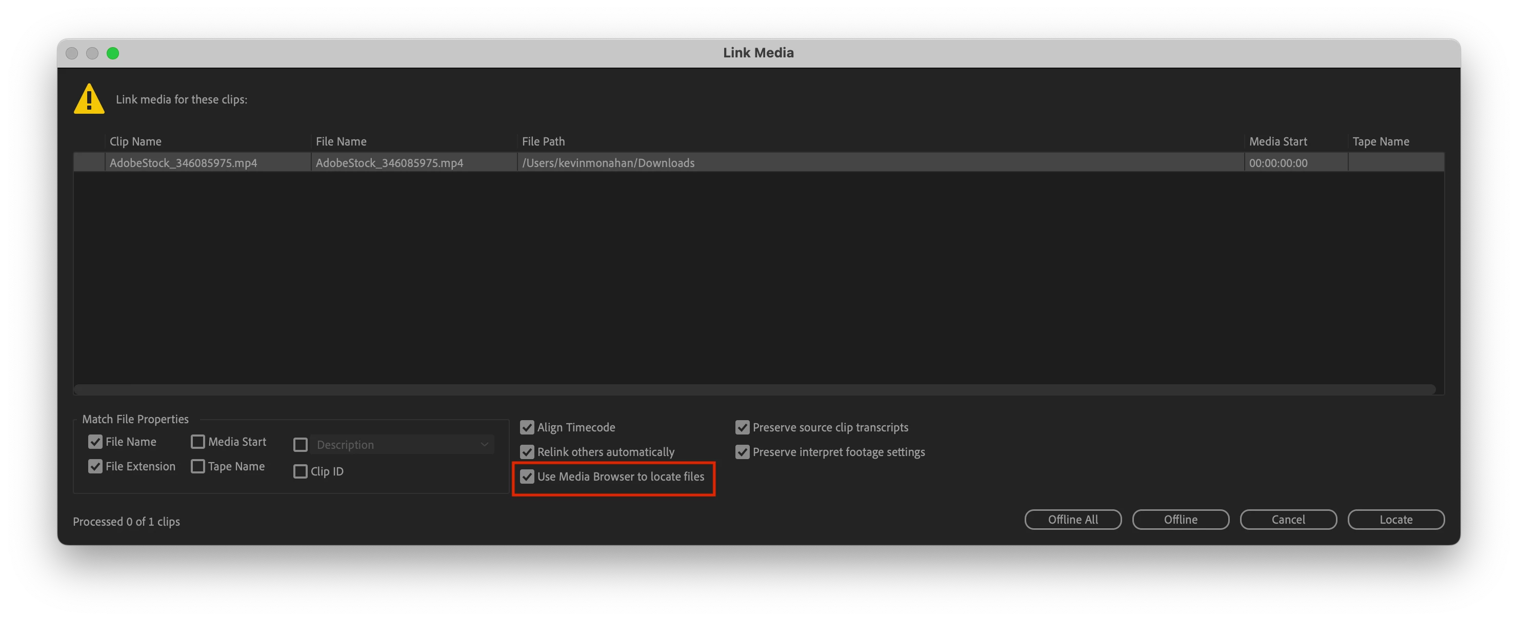

It's frustrating having to use Premiere's media browser instead of the system UI. Is there a way of setting that?
To get round this, I've been adding places to the Favorites section, however, it seems to keep resetting itself:
Is this a bug?
Thanks
Correct answer Kevin J. Monahan Jr.
Hi @ReginaldUser555,
Thanks for writing in. You say you want to use Finder/Explorer instead of Media Browser to relink media, right? I like to do that too. Uncheck this item in the Link Media dialog box. See the attached image. I hope it helps.
Happy New Year!
Kevin
Happy New Year!
Kevin
January 5, 2024
that's great, I didn't notice that! Thanks
