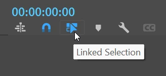

In bygone days when you linked A/V clips they moved in unison:, until you Unlinked them.
I've never understood why the Link option stopped working.

Might have turned off Linked Selection.

Wow! That's the correct answer.
I thought that icon did the same thing as the Link option in the drop down did!
Seems kind of counter intuitive. Thanks!
