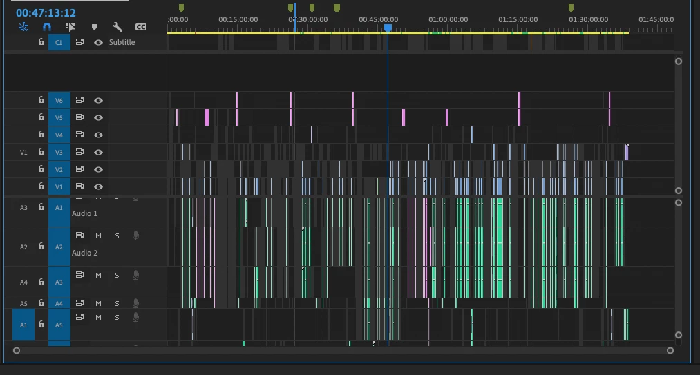

Also not sure if you guys are still around/can answer this, but here is an example of a cut of the master timeline, is there a reason why the preview files do not seem to render? as in the entire sequence is yellow. The preview file format is set to Pro Res LT, could this impact performance?
