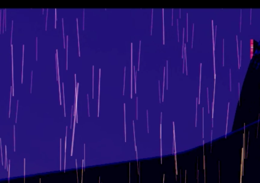

Jun 29, 2018 6:16 PM UTC
I've got the same issue.  Spent the past two years working on this film and coloring it.  The colors are meant be bright and saturated, but are dumbed down considerably.  Working on a 2017 iMac with 5k retina display and calibrated with a Spyder calibrator.  I looked at this same image on my macbook and the comparison is much less noticeable- as it may be for everyone not on a similar display as me.  I do believe this is a display issue possibly, but since I graded to this display how do I reasonable fix this?   Starting over with a new monitor is not an option for us.
Adobe please help!
R Neil Haugen
Jun 29, 2018 8:11 PM UTC
You've got a very basic problem. Within PrPro, Rec709 is used ... meaning sRGB, gamma around 2.2/2.4. Outside of PrPro on that monitor, you don't see that. That monitor may well be set to P3 or something like that, at any rate, a much wider gamut than sRGB.
QuickTime player is notoriously color stupid ... pays no attention to the color info in a video file header, just works at the screen's base settings. Chrome and Safari are also color stupid, Firefox is the only browser that pays attention to video color management.
So to evaluate the quality of your work, you need to work with a managed setup. Period. Which PrPro does its best to provide within the program and the monitors it has.
The other thing you need to understand is that once that deliverable leaves your screen, you control absolutely nothing about how anyone else sees it. As one colorist put it, you can't control gramma's green tv.
He'd graded a commercial for network broadcast, it's beautiful on a proper screen. Passed the stringent broadcast QC machines and all. Went on vacation, visiting gramma in Wisconsin. One of those folks who leave the TV running in the background all the time. While talking, there comes "his" commercial. Looking very green. Total yuck.
But that was only his response, because he knew what it should look like. Hers ... she didn't see anything wrong.
Why?
Because that's how everything shows on her TV. It's 'normal' to her.
Every screen, whether monitor, phone/tablet, TV, will be set differently, and almost zero percent are actually even close to "proper" setup for color/tonality. You can't grade for that because they are going to be every direction you can think of. And the viewing conditions ... a bright room will make the same program look very different than if, on that same screen, you blocked all ambient light.
New folk at this always come back with "but my viewers are all gonna use X browser or YouTube ... how can I make sure they get what they're supposed to?"
Well ... you can't. Everything I said above still applies. Some of those screens are going to be smaller than sRGB for color gamut, and your material will be very saturated, over saturated on those, especially if viewed in controlled or dark lighting conditions. Some of the screens will be A-RGB or P3 or whatever, a larger than sRGB gamut, and they'll use non-managed viewing apps. Especially in a bright environment, your material will have lower saturation. Yep. As will all professionally produced media on that screen through the same app.
So your material, produced to b-cast standards ... will look like other material produced professionally on that screen in that viewing app.
If you try and outguess, your material will look better on some screens, but far worse on others. And whatever you do, it will not be the same as other professionally produced media on that screen and viewing app.
Once out in the wild, it's outta your control.

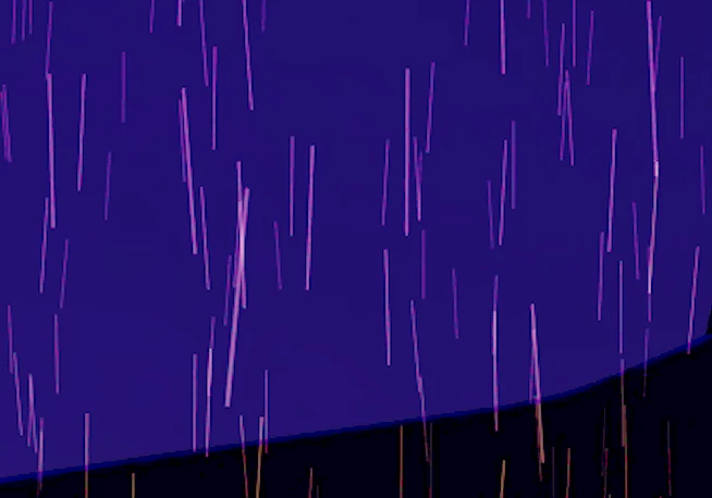

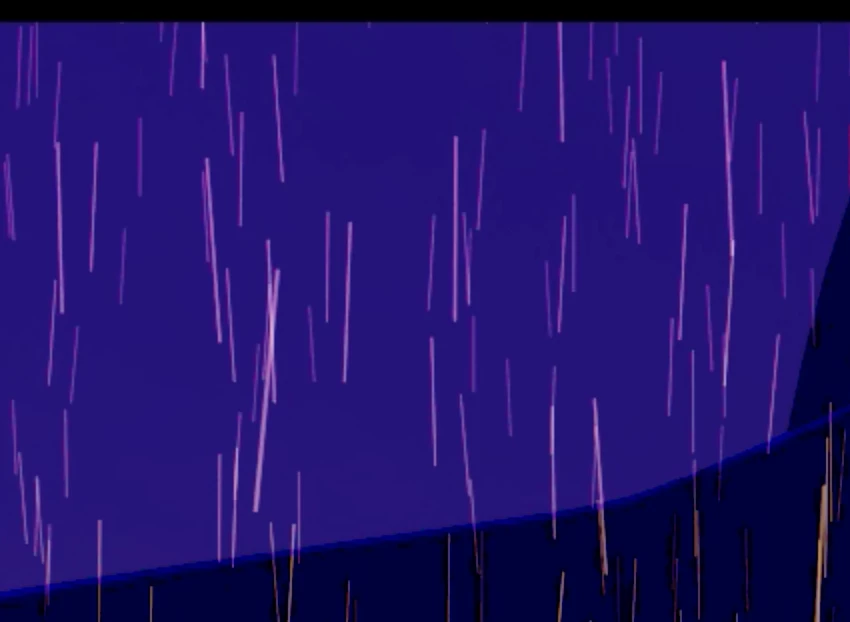

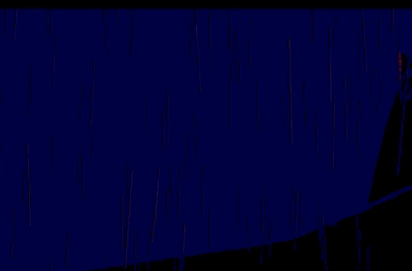

Anonymous290
Jul 19, 2018 7:56 AM UTC
For my 2.5 D animation movie I use Pr CC 2018. Here some two (the second group at the middle) shots (a sky night - with light), all with the same export settings H264. Except the two last with IRE 109 checked. The two first snapshots are from Pr preview.

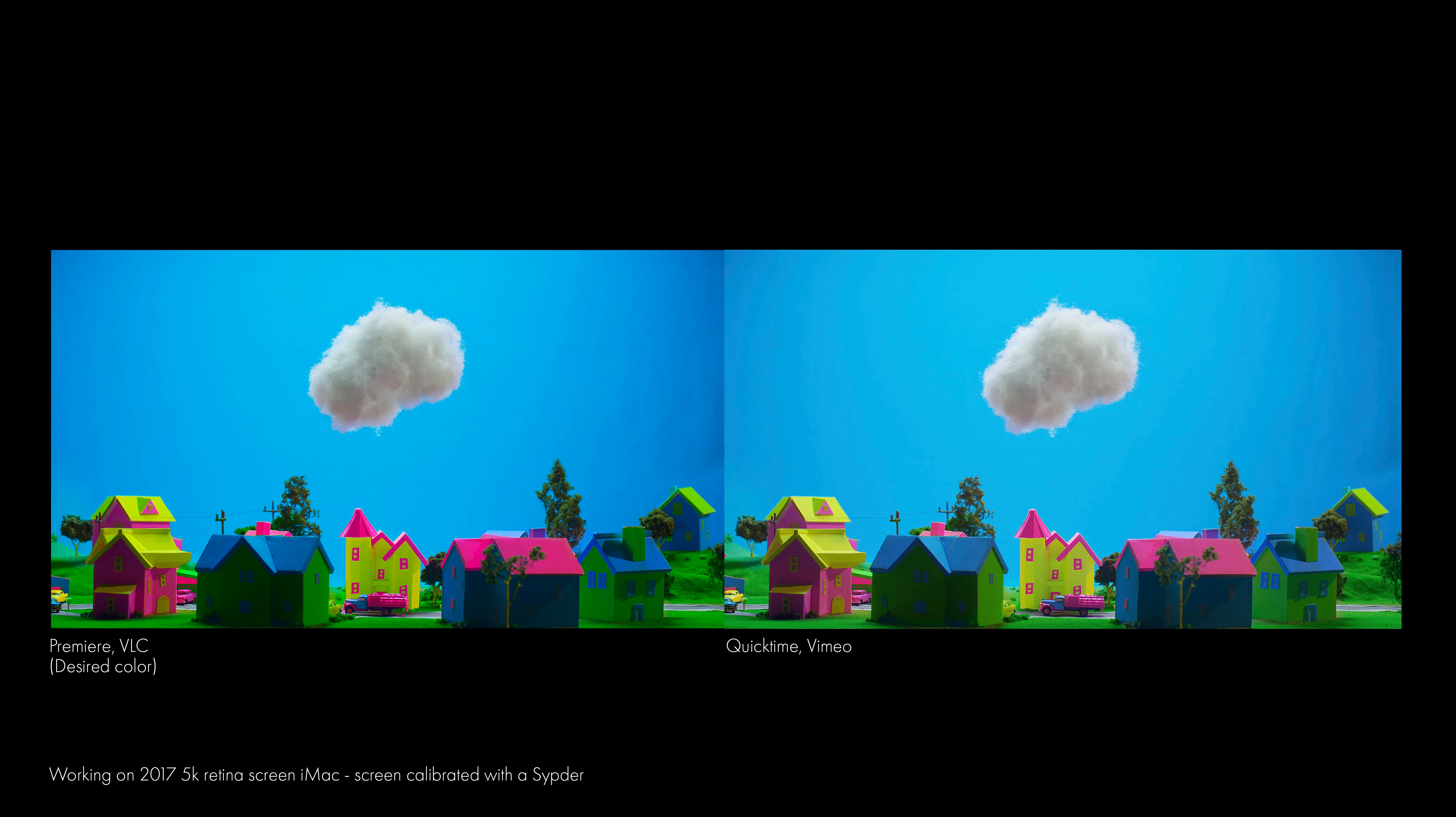

Jun 6, 2017 4:16 PM UTC
This is a problem with Quicktime, not Premiere. Open your video in VLC -- you'll see the coloring is fine.
p1xxx
Jun 7, 2017 4:18 AM UTC
It's quite a major problem when quicktime, youtube, vimeo are all having the same issue. if this statement is true, which it looks like it may be
"PrPro is 'modern', and simply assumes as the full standard for Rec709 is 0-255, everything that plays Rec709 media should play it correctly. And apparently doesn't bother with a tag to say "yea, this really is Rec709 media ... ".
So what I have figured, if premiere doesn't apply the tag, the main apps / websites we use don't seem to pick it up like VLC does.  I have tried every possible combo of exporter to add the tag, handbrake, mpegstreamclip, media encoder and compressor. (the source file is my prores422hq export file)  I also did the DNxHD export from the timeline, same results, desaturated on youtube too
i have changed my imac screen to rec709 colour settings and like with vlc, it looks fine. but every other normal human viewer would not do this, just use their mac default. I cannot get the world to use vlc or change their colour settings, there surely must be a way to make qt and and the imac colour system recognise it like vlc does.
Compresser has a colour tag which i can force to rec709, however the mac doesn't see it.  and also shows split screen input to output. The closest thing to a solution i found is to enhance the export. But that will then look bad on PC / non mac and qt environments I assume.
even the quick display pop up window on the mac is desaturated. (maybe thats QT driven too). I just don't see how it can be fine in premier, AE and vlc but bad in every thing else. It makes grading to my screen kinda pointless.
