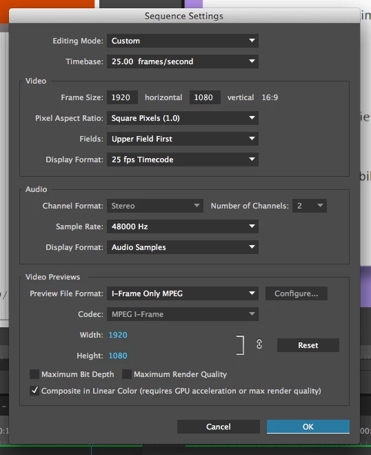

    Could you give us a screen shot of your sequence settings.
    toms2208
    toms2208Author
    June 1, 2017
    Hi Richard,
    Sequence Settings below...
    June 1, 2017
    I would be surprised if the PowerPoint presentation is interlaced, try changing the fields to progressive (none)
