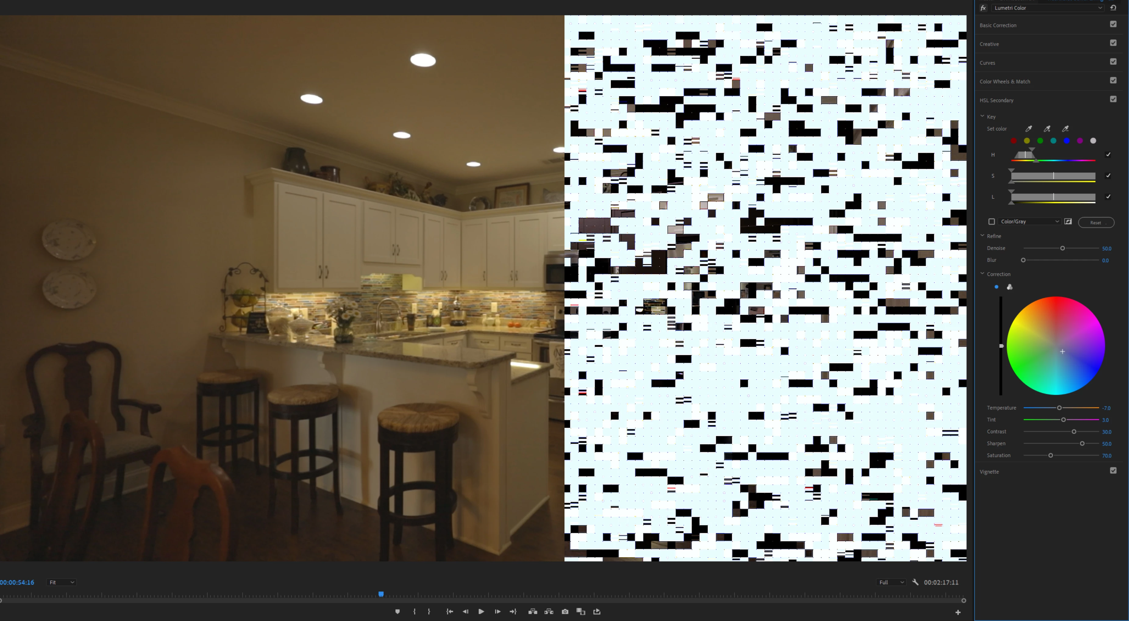

Please advise. When color correcting in premiere pro, I started running into this issue where if I adjust anything in the lumetric color, my footage becomes pixelated. Literally any adjustment outside of basic correction, this issue occurs. I can add a LUT, or edit curves, anything. I tried making adjustments to the clip directly and editing an adjustment layer, both had the same result. At first I thought it was just the preview, but when I export the same issue occurs.
Has anyone else run into this issue?

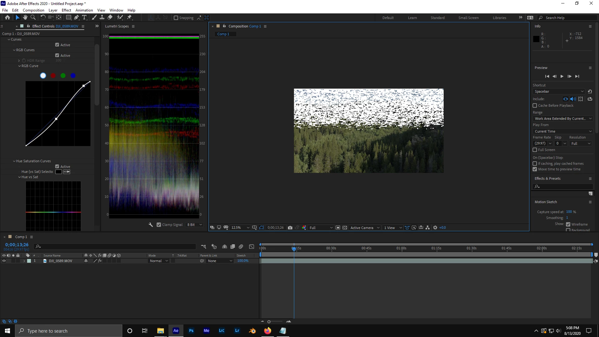

Ive got an even worse issue whilst using Lumetri Color in After Effects. More so using the curves or basically anything below that line up of control. Im beginning to think this is   yet another 2020 bug and issue. Terrible year. Okay so,.. I havent the slighest idea why it does this, hoping one can help...
My PC carries the i9-9900k, with a GTX 1080 Ti, 128gb of ram.
Running 17.1.2  - 2020 After Effects.
R Neil Haugen
August 14, 2020
Which driver are you using for the GPU? That sort of thing is nearly always a driver issue.
Neil
Everyone's mileage always varies ...

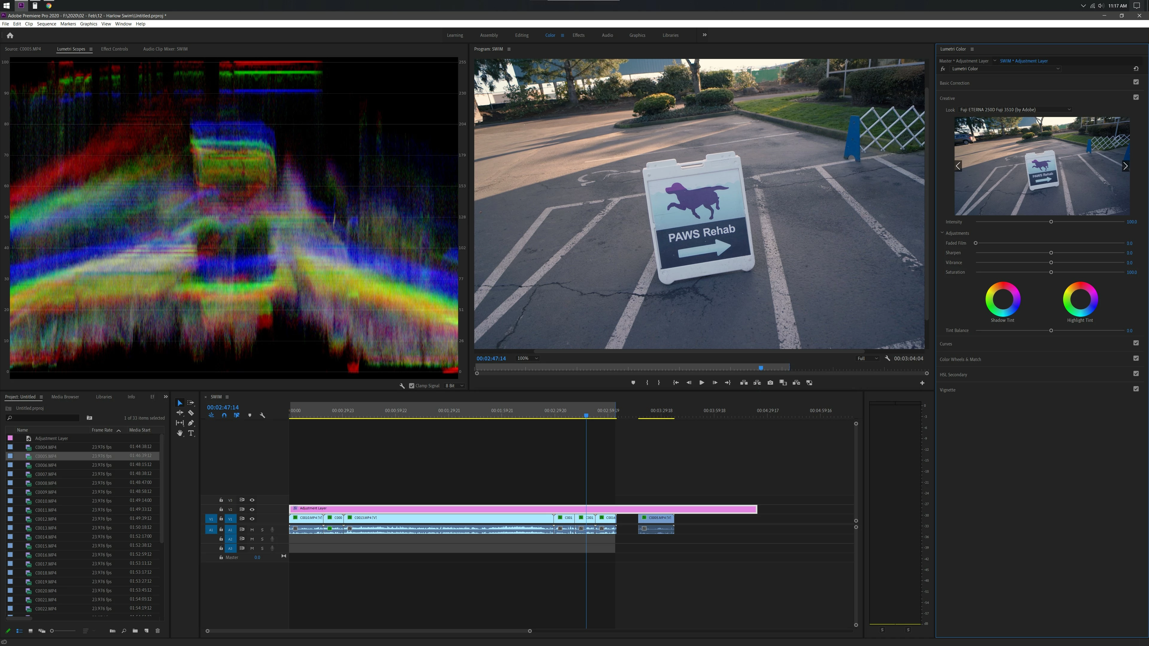

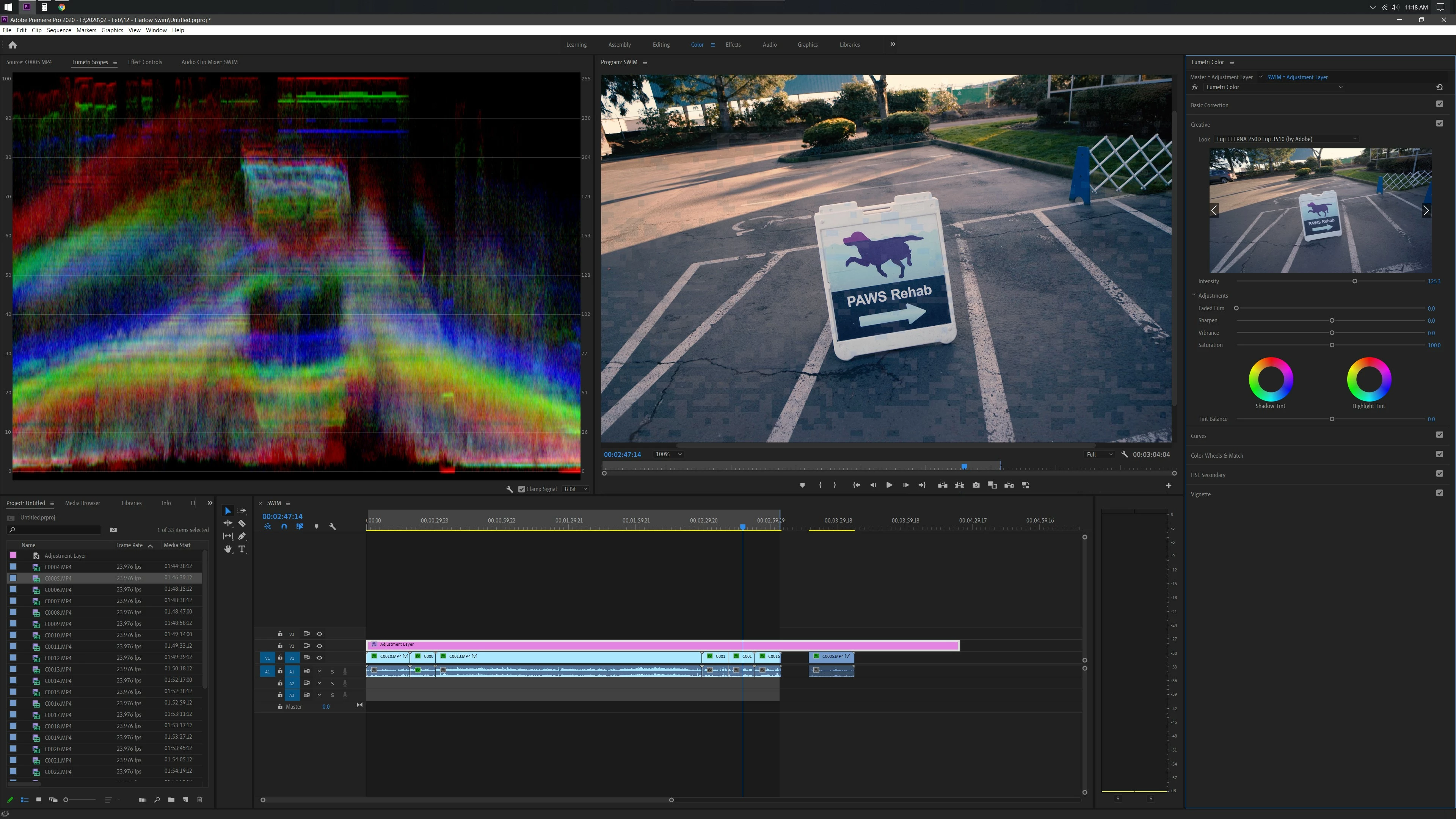

I think I'm experiencing the same thing but to a greater extent. In my screen shot, the left side is what it looks like without Lumetri and the right side is what it looks like with it. Any adjustment to Lumetri Color causes the image to be massively garbled. It is happening with 2K footage shot on a Canon 5D mk IV in C-LOG profile using All-I compression in an MOV container. It does not happen with 4K footage shot on a Mavic Air in the same project. Rendering the clips does not help. Restarting the computer does not help. Setting the renderer to "Software Only" works around the problem but is also much slower.
I can work on the same footage in Resolve without issue.
PP v 14.3.0
Nvidia Studio Driver v 451.48
ASUS GTX 1070 Ti
Threadripper 1920x
32GB RAM
