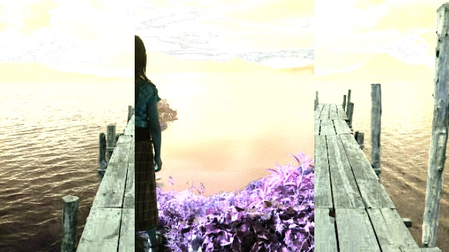

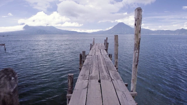

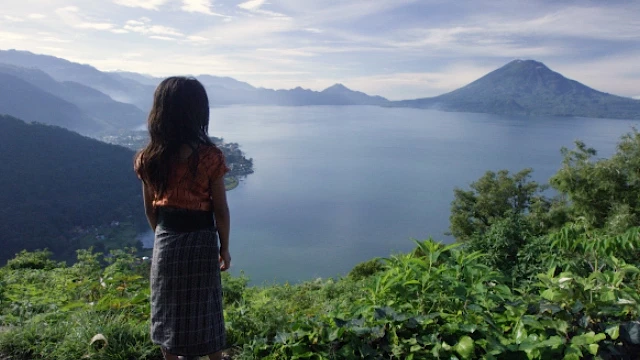

In Adobe Premiere, (most current version) I'm having problems with some of my transitions going posterized or solarized when I the clips have Lumetri color applied.  I removed the Lumetri color effect and the transition works OK.  Here are screen shots:
clip with lumetri color applied before transition:
barn wipe transition between clips:
Clip after transition with Lumetri color applied:
This doesn't happen with all effects, but it does with several wipes, page peels, additive dissolves, etc.  Is there a fix for this?  Would love some help on this.  Thanks.

    Hi Byron,
    Sorry for the issue with color and transition. It can be a compatibility issue with GPU drivers/renderer.
    To corner the issue, change the renderer in project settings and try the same effects.
    Here are the steps: FAQ: How to change the Video Renderer in Premiere Pro?
    Please let us know the status.

    bdurham360AuthorCorrect answer
    January 9, 2019
    Thanks, Vidya.  I did the changes you suggested and I didn't see a change.  BUT.... I deleted the current Lumetri Color effect from both clips and applied Lumetri Color again with different settings.  It seems I no longer get the solarization effect anymore. Everything seems to be working OK now.   Maybe it was something in one of the settings.  Thanks.
