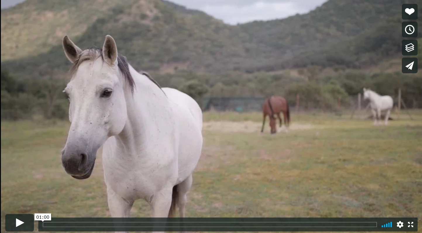

    If you get into doing 'steps' of correction ( first grade, second grade, etc. ) and start saving your own grades to export as luts and stuff, then maybe that would be called grading more than correction. To me they just mean the same thing in general.  This horse ( was a lesson in resolve ) was from a blackmagic cinema camera and some lut was applied from the start to get to rec 709 but it was really subtle difference. The sky was blown out white and the blue sky with cloud was another image as a composite done in the color section ( not fusion ) and the grass under the white horse ( everything in front of the brown horse ) was turned green from a really burnt out hay like color. Some masks had to be used ( selection of areas, power windows, etc. ) and some of that I would call grading intead of correction because there wasn't anything 'wrong' with the burnt out grass.. that's the way it really was. So correction is more like when something is 'wrong' ( not like it was when you shot it ) and grading is more like changing or making what is right even better ??  Like skin tones and so on.  Or details. It's kinda hard to really be exact about the definitions for me at least.
