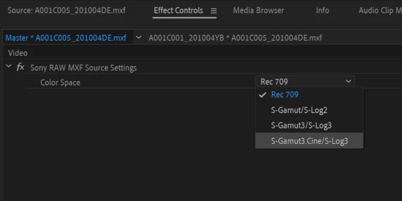

For all those interested, I found the solution!
After you bring your clip into the timeline, click on "Effect Controls" and there will be two tabs. Click on the "Master * [clip_name]" tab and there should be a control setting that looks like this:
Click the dropdown menu and select "S-Gamut3.Cine/S-Log3". As far as I can tell, this only works after it is in the timeline, and it won't work when looking at the "Source" window for the clip. This also means you will need to go in and manually select this setting for every clip in the timeline. But at least it's something. If someone has a way to apply this setting to all the clips, please feel free to share. (Copy/Paste Attributes does not work.)

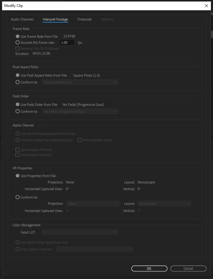

October 30, 2020
Check the Media Properties in the Project panel. Right-click the clip, then select Modify/Interpret Footage. That's where they've moved input LUTs and color space options to.

October 30, 2020
This is the only thing that comes up when right clicking Modify > Interpret Footage:
