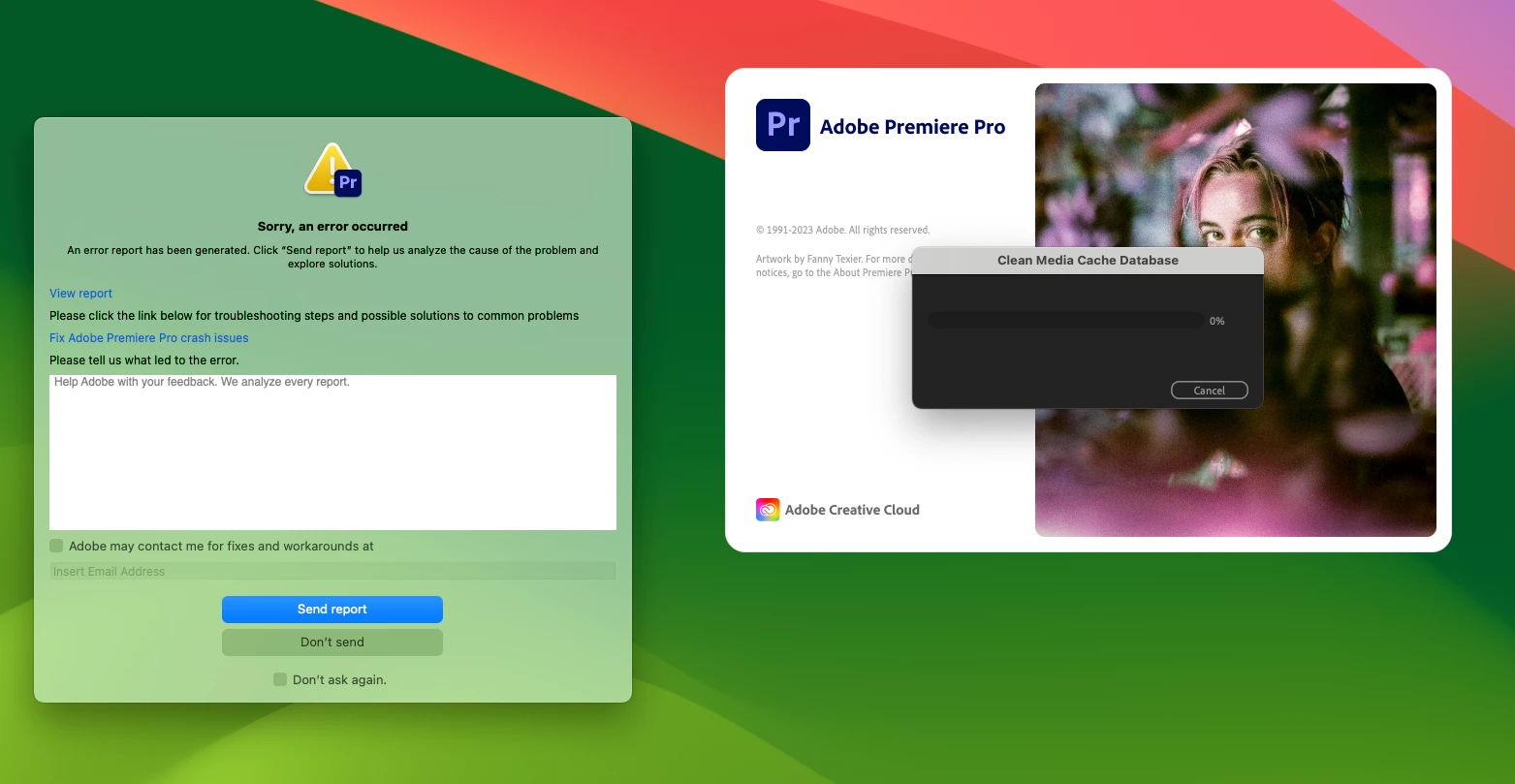

  • Reply with a screenshot of your splash screen. It should show the module it is hanging on.

@Kevin-Monahan - here is what I just did:
  • Plugins:  I haven't installed any because I had to "Erase all Content & Settings" and then upgraded to Sonoma, so my computer is clear of plugins - I have not installed any.
  • Checked system settings....all is correct
  • Checked the KB doc (found that earlier) and permissions are Read/Write for my user
  • Pressed Shift at launch --- nothing. Of course I have already uninstalled, rebooted, reinstalled thinking it would help so there is nothing to reset and clear I guess....but the splash screen came up and then it just hung - no progress bar or anything.
Here is my Mac:  Mac Studio 2022, 128 GB, Apple M1 Ultra, 2 TB drive, three displays (39-inch 3440x1440 - 21.5 inch 1680x1050 - 21.5 inch 1680x1050), 48 cores, Sonoma 14.2
