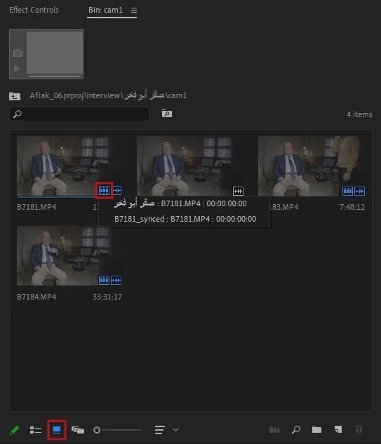

Also, in the icon view, you can click on the blue icons in the right bottom of a clip thumbnail to reveal in which sequences your clip is used:

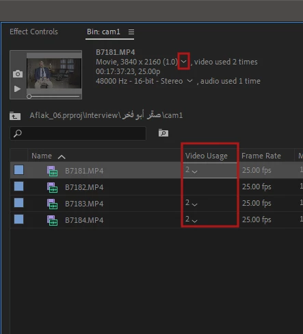

Your clips are used somewhere which prevents you from deleting them using that command. To know where a clip is used, either enable preview area in the project panel, or add video usage column to your project panel, you will see how many times and where your clip is used.
