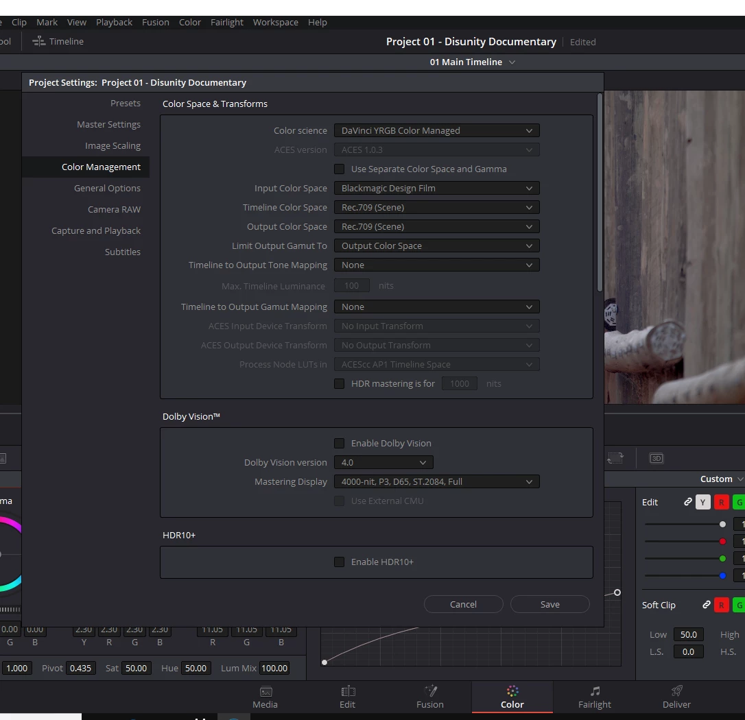

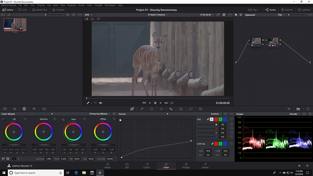

    But anyway, here's some screenshots.  They are 1) color space settings for source timeline output etc. 2) original footage ( flat unsaturated) 3) initial adjustment saved as a grade ( which can then be applied to all the clips shot in same light etc. ).. was showing someone how to turn the nodes on and off ( see original compared to grade ).
    important thing is to keep shooting and editing and note that you and me and a million others have been dealing with this sort of frustration a real long time.

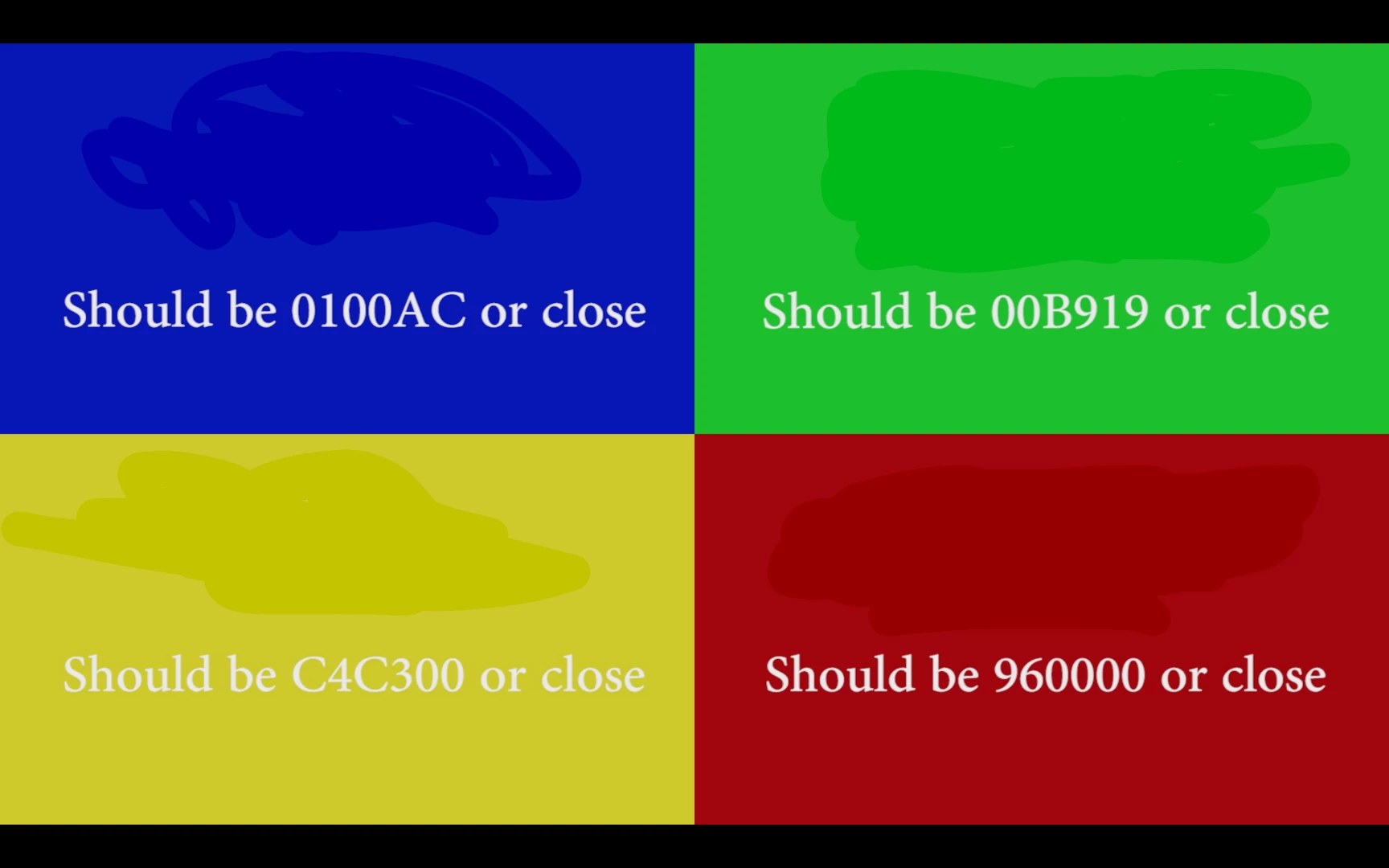

    josho16037086
    December 19, 2018
    I guess I just don't understand how this can be a monitor calibration issue. It isn't even about grading--raw, completely untouched footage will come out visibly more washed out on a lossless export.
    I'm telling you I can export video of a lossless prores with nothing but a solid color made in Premiere or AE as footage, and the resulting export color won't even come in the ballpark of the original hex code. I realize I could be misunderstanding something here but something definitely seems wrong.
    (notice the brush scribbles within each rectangle)
    The rectangles here were my Premiere mattes and are supposed to match the hex codes listed. The brush strokes within those rectangles are made with the exact same hex codes, laid on top using PS CC. As you can see, the exported color visibly off.
    (NOTE: yes, these brush strokes were made on top of a screenshot from the export, which I then scribbled on top of with the correct color with a brush in PS. I realize screenshots won't capture exact color and so of course there will be contrast. So I did a test--I loaded up my hex codes on coolors.co, exported a PNG, screencapped that exported PNG, and then colored on top that palette with the correct color. Same exact process as before, only the color differentials weren't even distinguishable to the naked eye the way they are here.)
    Why is the same monitor displaying the same hex code so differently when I export from Premiere? I don't want to overcommit to being indignant here--I realize I'm not all that savvy about this stuff, but the idea that this is a monitor calibration issue still doesn't make any sense to me.
    R Neil Haugen
    December 19, 2018
    Yea, this is hard to wrap your head around. What you're expecting is that all apps/OS/hardware applies the same ... standard ... to showing video.
    This does NOT happen ... period.
    There aren't standards being equally applied across the apps & systems is the problem ... and there's no way to MAKE them outside of running a tight system where you set and control EVERYTHING to run by the same standards ... and then, it will only look that way on your system.
    And this situation is dealt with by every colorist out there ... period.
    PrPro runs internally according to the by-far most common pro standard, Rec.709, which is by requirement using the sRGB color space for the monitor and both the original camera transform function of the original Rec.709 standard and the updated monitor transform function added some years back in Bt.1886 ... all set within an assumed monitor gamma setting of 2.4.
    That's what it attempts to show within the monitors of PrPro on your monitor.
    This IS dependent on your monitor being set for video sRGB/gamma 2.4 with a puck/software calibration applied to the signal sent through the OS. For the new Macs with the P3 wide-gamut monitors, the added option of "enable display color management" is there to help PrPro try to outguess the OS and the monitor as far as showing the proper image within that monitor. Works fairly well on some systems, not so much on others.
    All exported material from PrPro will be created within the codec's specs ... which for the vast majority of codecs is video sRGB/gamma 2.4 and with the transforms applied. Any device and screen set to properly display video Rec.709 signals will handle it appropriately as long as the viewing apps also recognize the proper standards for video or the OS/video-card settings apply them to all apps.
    But on any system that is not set with a monitor displaying video sRGB/gamma 2.4 and calibrated to that, what is shown ... can be all over the place.
    There is no way ANY app can outguess and over-ride all hardware/OS/apps ... period.
    Colorists work on setups that involve expensive broadcast monitors as "confidence" program monitors that are then 'fed' from external boxes that have LUTs in them built specifically to calibrate that monitor to an amazingly tight standard to the Rec.709 standards ... and for those who work other 'spaces', say Rec.2020 or DolbyVision HDR, those also. The calibration of those monitors is done by gear costing more than your entire system and then some ... and most of them then hire someone with "real pro" gear to come in once/twice a year to set a new base calibration.
    Broadcast companies have QC "boxes" that all material is run through ... any saturation or brights excursions, too many super-blacks, it's rejected ... a very bad thing for a colorist's reputation.
    But even then ... as soon as material is broadcast "into the wild" ... there is no control on how it will be seen on any TV or computer screen out there, as there is normally no calibration, the screens are all set to "enhance the viewing experience" or lift shadows in dark sections ... and at times the screen is in bright lighting and other times a darkened room, which both drastically change how things look on that screen.
    So ... what do you do?
    Set up your system as close as possible to run by broadcast standards ... check your material on a full b-cast setup, either with a colorist you find/know or a local TV station, if you can talk them into running a short clip of yours through their QC machine and bringing it up on one of their systems.
    Then you know your material is as close to "pro" as you can make it.
    Then ... when you send it out into the wild, let it go ... and move on with life and work.
    Which is all the highest colorists can do, how can you do more? You have no control of the systems and apps people will use to view your stuff. As long as you produce pro-standard material, on any screen that it is viewed on, it will look like other pro-produced material on that screen.
    And ... it will never, ever, even in any parallel universe, look exactly like it does on your screen. Which is in reality a physical impossibility.
