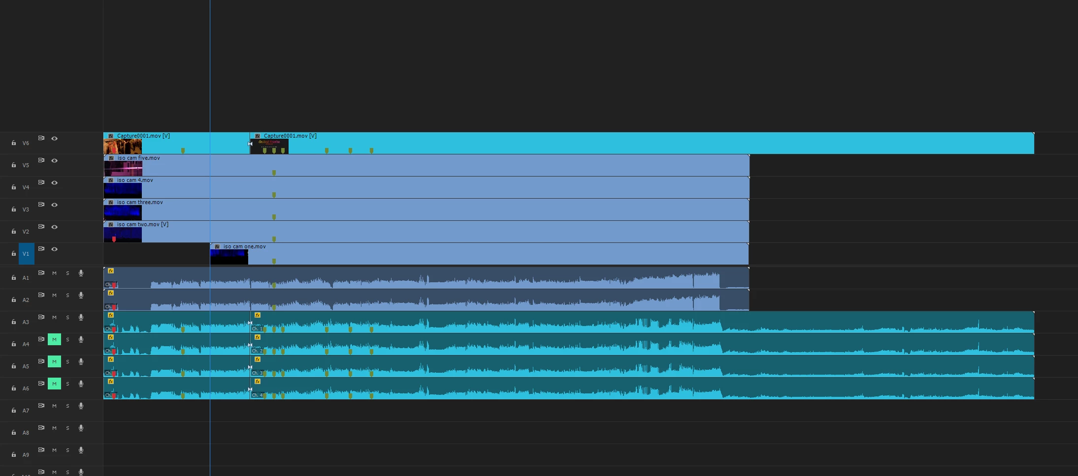

    You don't need to nest your source clips in order to group them as one camera.
    Put all your clips from each camera into their own tracks in one single Sequence, and sync them up.
    In a new Sequence, place your prepared Sequence and right-click > Multi-camera > Enable. Each video track from that sequence will be treated as a separate camera.
    If you want to use proxies in your source MC Sequence, then go ahead and do that. When you are ready to export, you can update your source sequence with the original clips and have your edited sequence update too.
    Your source MC sequence might look something like this (but with a lot more clips per track I would imagine):
