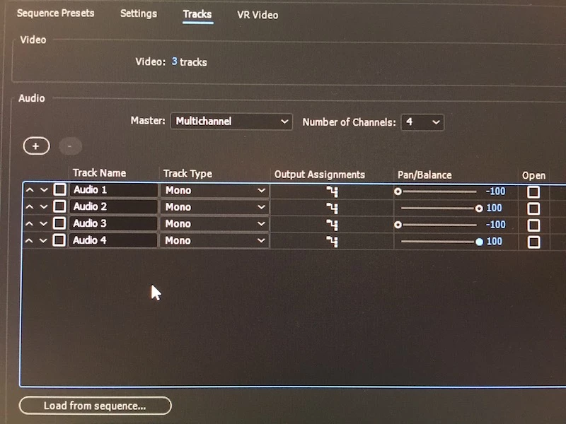

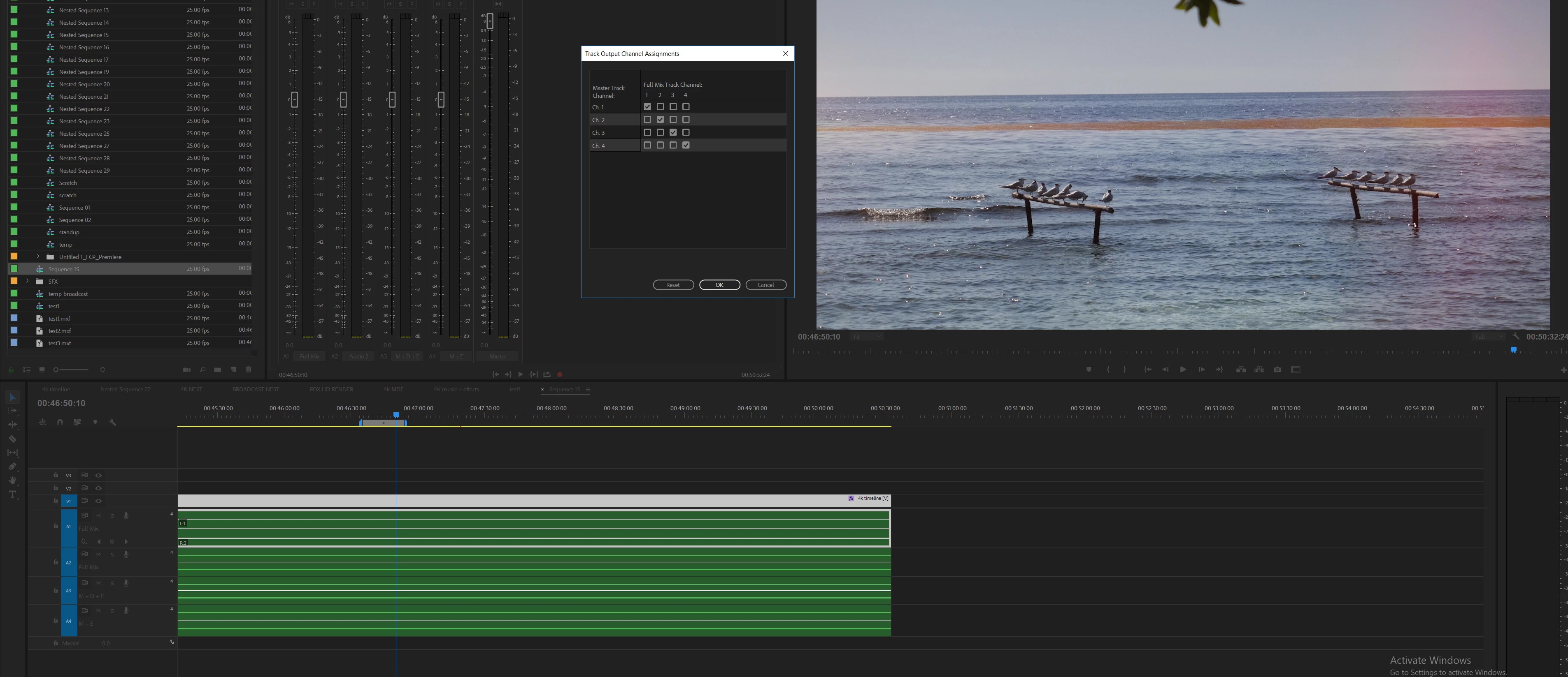

Here's a pic of my setup.
Thanks in advance.
Jogen
November 25, 2017
Make a new timeline with mono channels. Change your master audio to mono tracks (-> right click on clip in proj window -> modify -> audio channels). Audio for Track 3 and 4 should be mono, too.
