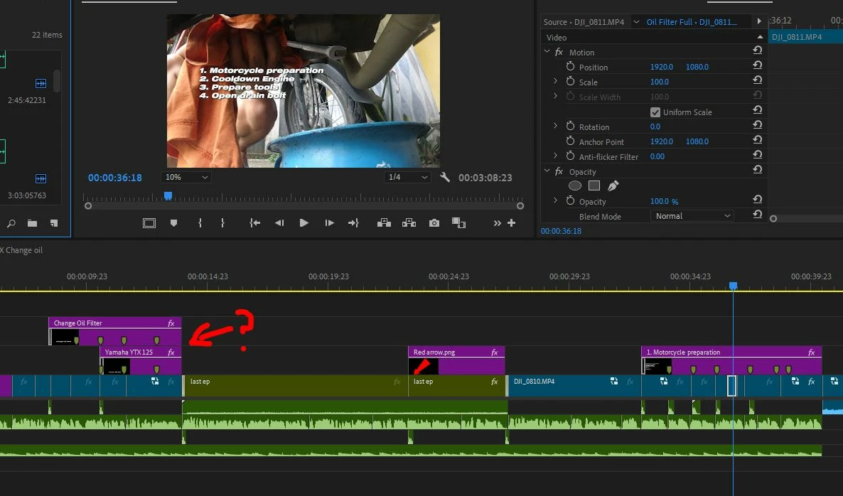

I made a text layer and put text in it. Then I duplicated it using alt and drag to the desired timeline.
Then my current layer that has a different text needs marking. So I used Mark tool then I noticed that it also mark the text that it came from. All the text that has been duplicated are affected by the marking bug. It copies to all the text layer.
Though its not affecting my output. I think you should fix this.
See images attached for reference.

Hello @Budget Byahero,
Thanks for filing your bug report. Have you tried the solution provided by @Mo Alani? Let the team know if it worked.
Kevin
Mo Alani
August 12, 2024
Hi Budget,
To solve this, do not duplicate the text layer using the ALT and DRAG method. Use the CTRL + C Copy)  and CTRL + V (Paste) Method, thats will solve your issue, and just did another test to double check.
Please elt me know if thats solve your issue.
