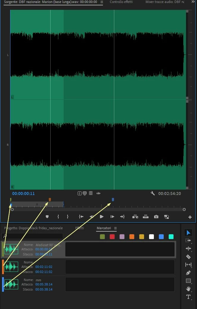

Hi, i have a problem with marker, if deleted they reappear when the project is reopened.
I analyzed them, they are not blocked, they are not present if I open the file (audio in this case) in Audition, I delete them and every time the project is reopened they reappear, is it a bug or is it something that needs to be definitively deleted?
I specify that it only does this in this audio file (wave).
Thanks to anyone who can advise me.

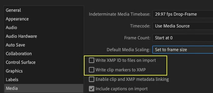

Mejor respuesta de Stan Jones
I don't understand that Audition doesn't see them. Are PR markers not the same as Audition markers? I just don't know.
Anyway, having XMP on DOES save to the file itself. If the markers were saved to the file at some point, and XMP is now off, the file will NOT update to remove the markers when you delete them.
I just tested, and in such a case, when I reopen the project, it appears to scan the file and again shows the marker.
So turn XMP on, clear the markers, and turn it off. I found that the file was updated instantly.
Does that work for you?
Stan

I did the test you suggested and it worked! Now I wonder why the "Write marker in XMP clip" function is deactivated by default? What is its usefulness and function?

October 10, 2023
just a quick guess:  Could it have something to do with the settings for preferences:  media:  "write clip markers to xmp" and "enable clip and xmp meta data linking."   Worth a quick test.
