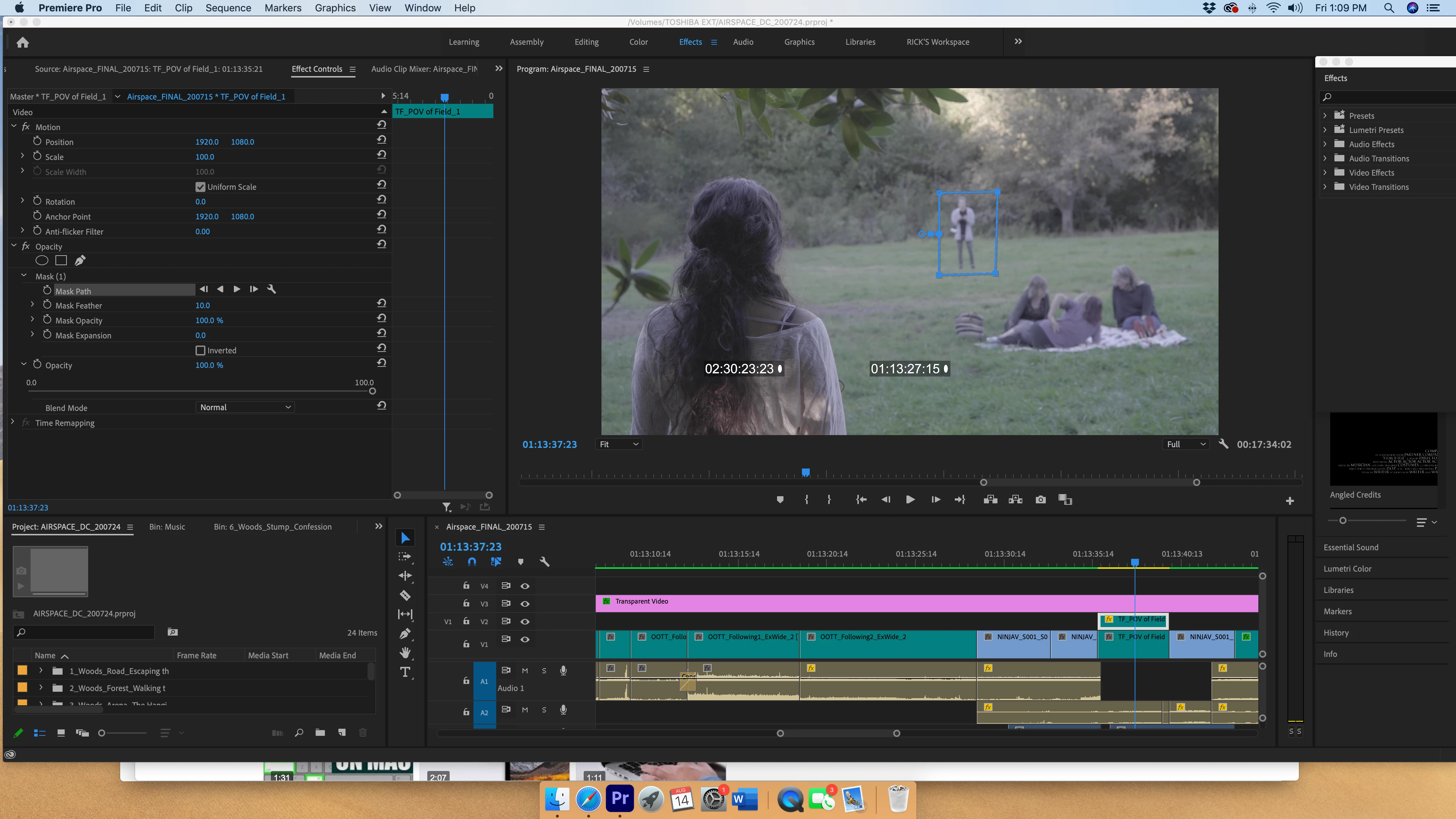

Hi ~
I'm trying to remove an image and I follow the instructions to grab a similar background but when I try and move it over to the image I want to remove, nothing happens. Please advise.
Thank you!
Correct answer Meg The Dog
With the mask in the first positon, click down on this number and drag to the right (the cursor with change to a icon with two arrowheads pointing left and right):
MtD
August 14, 2020
Ooops, sorry, I meant the number on the left.
MtD
August 14, 2020
It is hard to tell from the information you have given what your are doing.
The way to do what (I think) you want to do is
Clip to fix on V1
identical copy of the clip on V1 on V2, directly above the clip on V1.
Use the Opacity mask to cut out an area of the clip on V2 that is just background
Once the mask is cut, use the Position and Scale parameters in Effect Controls pane under Motion for the clip on V2 to move the selected area of the background to cover the area on the clip on V1 you want to cover.
MtD
August 14, 2020
