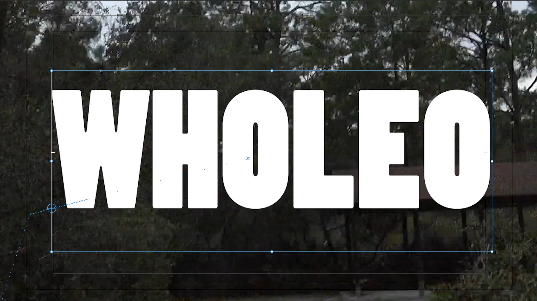

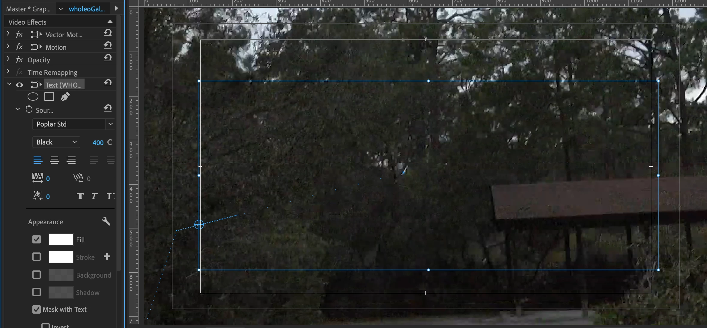

I type text on a layer above a video layer. I click "Mask with text". The text goes transparent. Alternatively I can add a Track Matte Key to the video, with Matte as the text layer and the text does act as a mask. Why doesn't mask with text work for me?
I upgraded Premiere Pro today (13.1.2 build 9), have not been having any other problems.

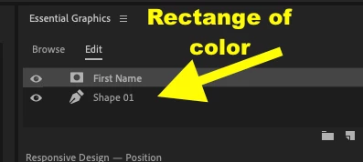

    Yes, as I said in my first post, it only works on elements contained within the Essential Graphic. Your graphic only has type. You click on mask with text and there is nothing for the text to mask - so you get nothing displayed.
    In your graphic add another layer - like a square of color - beneath the text, as I showed in my example.
    Then you will see the text cutting a mask:

    Text layer over video layer
    Click "Mask with text" box on text source and it goes invisible.

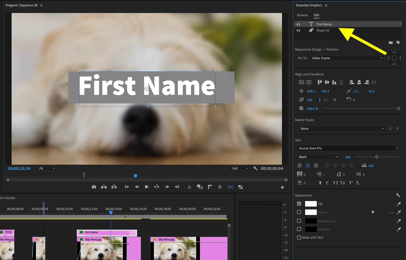

    "Mask with Text" in Essential Graphics works only on elements contained within the graphic itself, such as this example that has text over a gray bar:

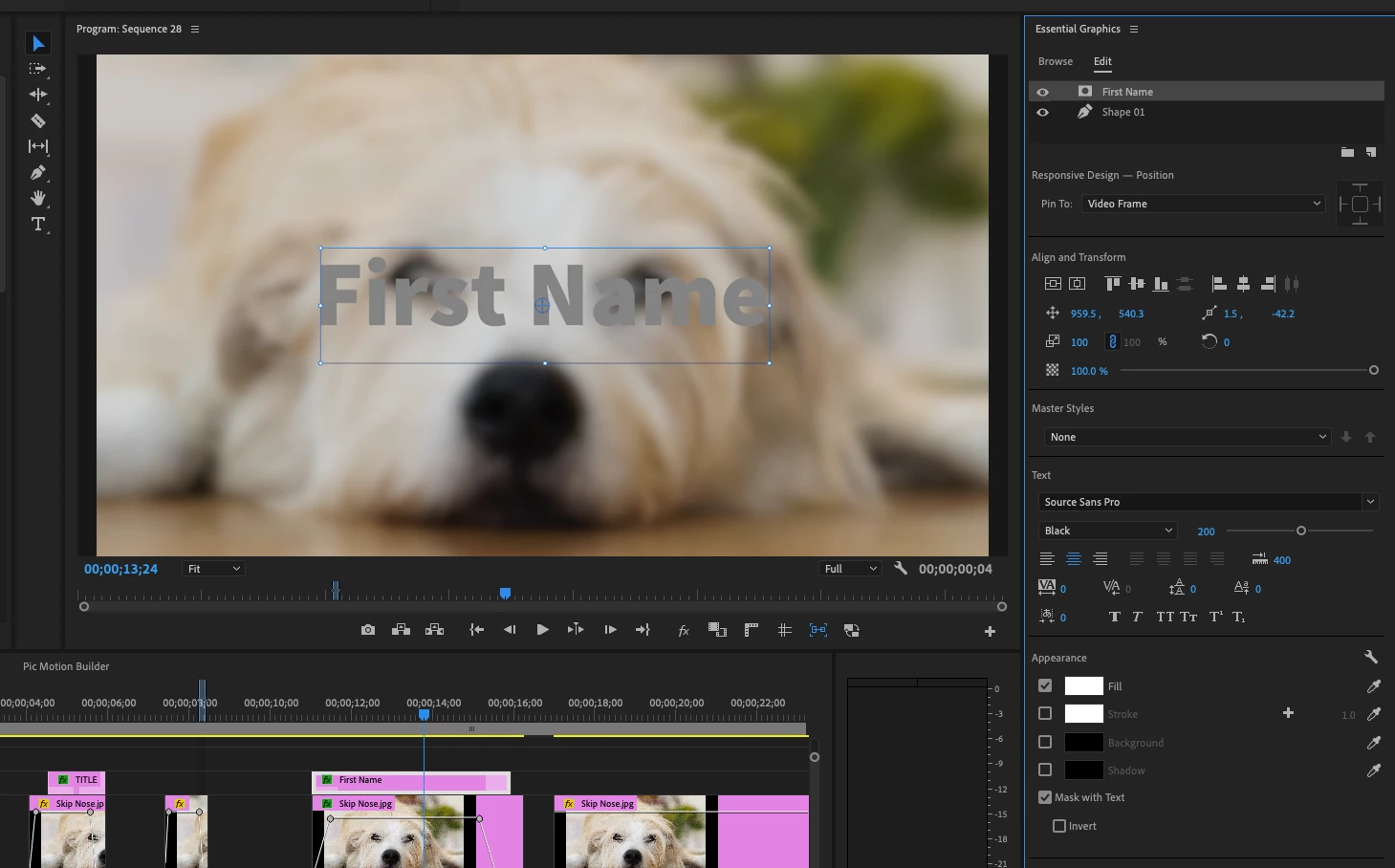

    If i select the text layer and check Mask with Text, it works:
    To do what you want, you must use the Track Matte effect.
