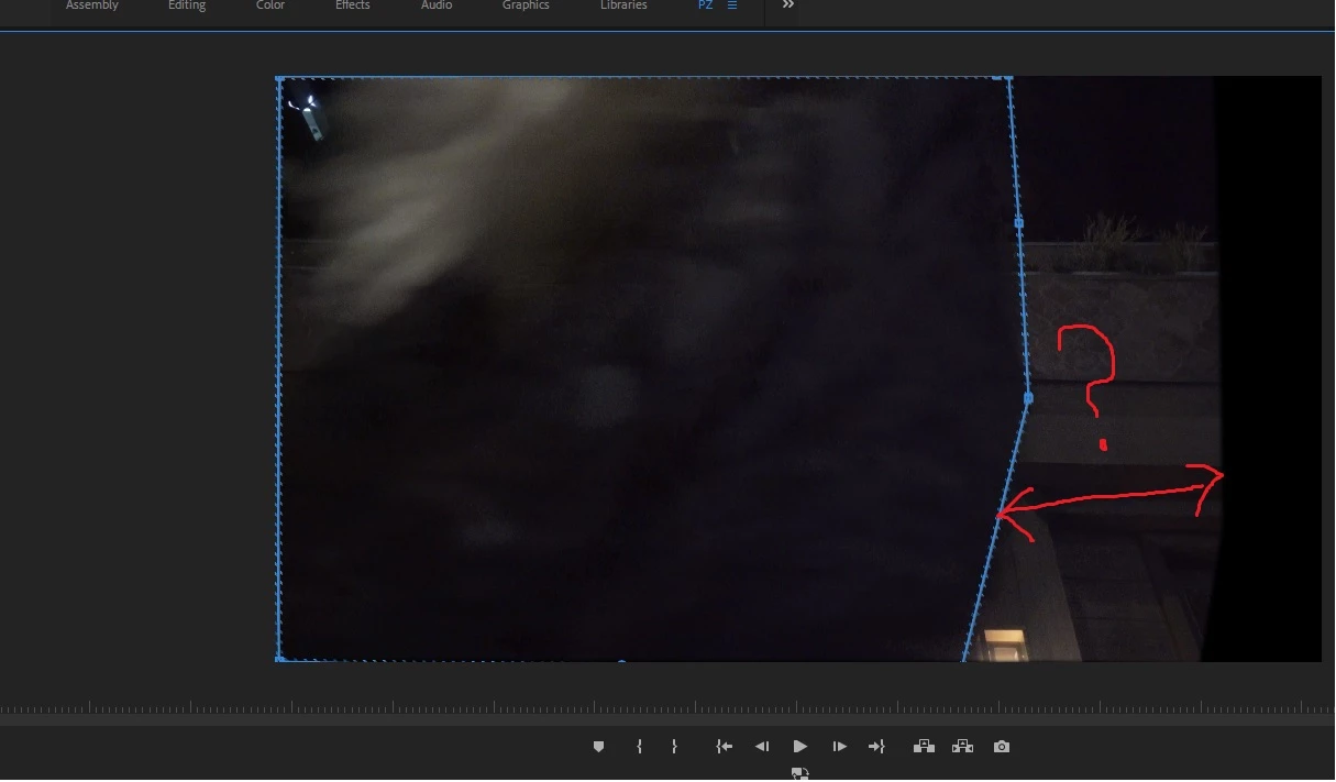

Hi guys, I'm experiencing a very weird problem. When I draw a mask, with the pen tool on a clip (to create a simple walk by transition) the mask that I drew doesn't match with the actual area that is being masked by the program. It's impossible for me to mask the area that I want in this way! I don't understand why this is happening! any sort of help would be super appreciated.
As you can see there's this weird gap between the mask area that I drew and the actual masked area. This is becoming a nightmare! I'm using the latest Premiere Pro 2018 verison.
Correct answer partnerss79277407
Are the Adjustment layer, media clip and sequence all the same resolution?
Nope. That was the problem. So sorry guys.
The clip was 1920 x 1080 but, for whatever reason, the adjustment layer was set at 1440 x 1080 by default. I hit 'scale to frame' on the adjustment layer and the masked area popped back to where it should be.
Thank you so so much. Really sorry to bug you guys with such a rookie mistake.

Which property/effect is used for the mask?
Any other effects applied?
partnerss79277407
March 6, 2018
It's an opacity mask on an adjustment layer with one instance of Lumetri Color.
In the screenshot below, I've decreased exposure on the color adjustment in order to more clearly show where the affected area appears. It's inexplicably offset from the shape I've drawn. This is the case with every frame. The camera rotation and distance change rapidly in this shot which made the key-framing rather tedious so starting over is definitely a last resort.
